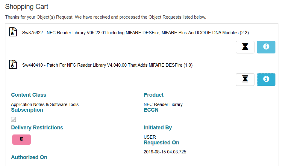

david13
Hi Jonathan,
I have applied for my wanted packages by using Shopping Card, hope get them soon.
pastedImage_1.pngBest Regards,
David Huang

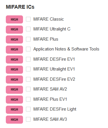

david13
Hi Jonathan,
I followed your suggestions to apply for raising my access rights. Now my access rights in Mifare ICs class are all in highest level but still cannot download this file. The download icon is in ACL, it looks I don't have the permission to download this file although I can now find it.
Is there any My Access tab setting I need to set up so that I can download the sw440410 package file?
My Access levels:
The download icon is in ACL state.
David Huang
