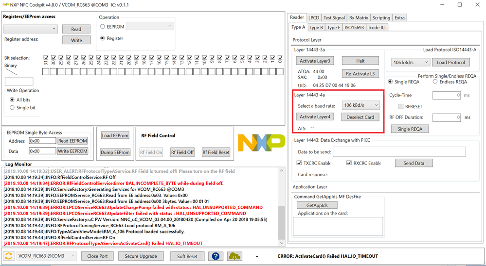

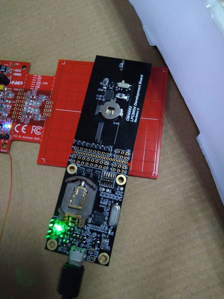

I’m getting started with NFC using 2 boards OM40002 as a card and CLEV6630A board as the reader.
I program the nfc example on LPC8N04 on the board OM40002 and it works successfully with the mobile app LPC8N04 NFC Demo.
But when I’m trying to test with default firmware of CLEV6630A using cockpit software, it didn’t run correctly. I got the error when activate layer4 as below:
Then failed when I tried to send some data:
This is our setup:

Hello, I just found the solution.
On the text field "Data to be send", we must follow the NTAG command which could be described here
https://www.nxp.com/docs/en/data-sheet/NTAG213_215_216.pdf
Sending any dummy data, the OM40002 board could not return.
Hope this would help for someone getting started with these two.
