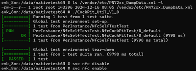

Hi Sir,
We follow Cockpit user guide and PN7220 User guide to execute cockpit_util_v1_0 on android for update eeprom value to PN7220
But when the cockpit_util_v1_0 finish, that PN7220 broke.
Update step as below
  1. Use Cockpit v8.1.0 to dump PNEV7220BP1 eeprom and svae to xml file. (as attchement)
  2. Push the file to /vendor/etc/PN72xx_DumpData.xml
  3. Execute CockPit_Util_V1_0 for update (as below screenshot)
  4. Reboot i.MX8MN and PN7220
  5. Re-connect by Cockpit v8.1.0 again
  6. Cockpit v8.1.0 can't connect (as below screenshot and pnscr.log/cockpit_issue_dump.log)
  7.  EMVCoAidlHalComplianceTest  checked also can't workable
Could you please help us to clarify the problem and how to recovery PNEV7220BP1
Thansk.
C.J.

Hello @chiajeng
where did you download Cockpit_Util_V1_0 ?

Hello @chiajeng
This tool (Cockpit_Util_V1_0) is no longer recommended. We suggest updating EEPROM with NFC Cockpit, which is reliable and stable.
