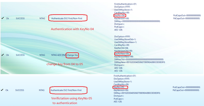

I'm currently experiencing some issues with changing the key for the NTAG 424 DNA. According to the document at https://www.nxp.com/docs/en/application-note/AN12196.pdf, specifically in section 6.16.2, if I authenticate with keyNo 01, I should be able to change keyNo 01. However, when I run the command, I receive the response 91AEh, which, according to the document at https://www.nxp.com/docs/en/data-sheet/NT4H2421Gx.pdf, means "At the application level, missing active authentication with the AppMasterKey while targeting any AppKey."

Hello @GlennN
Please take a closer look. The key has also been changed. In my test example, the values of key4 and key5 are different.

@KaiLiYes, sorry, I had missed the change of value in Key 5

Hello @shaghayeghnz
Yes, you're right. Once you authenticate with keyNo 01, and then keyNo 01 can be changed by ChangeKey command. The below test log for your reference.
