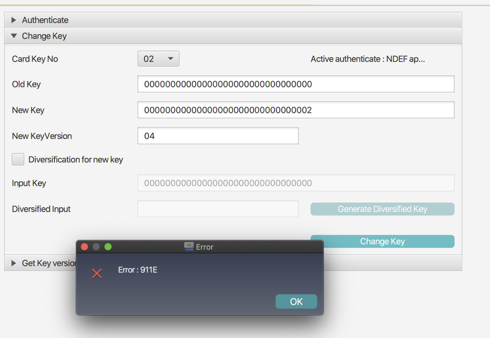

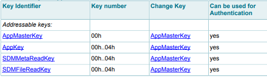

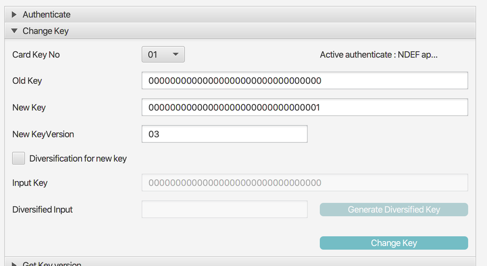

ok here we have two topics,  first on the key changing. the right process is the following:
1.- authenticate with masterkey
2.-change key 01
3.- authenticate again with masterkey as step 1
4.- change key 2
it is important that you know the information of the key inside the tag, if you happen to change the key in the past and you put the wrong key in the  fields this will lead to the error that happened to you.
 for example after this process tried to change again  the key 02 with the incorrect values  and this is wrong and will lead you to the 911e error.
for the encryption and decryption process the best would be to use the Application note NTAG 424 DNA and NTAG 424 DNA TagTamper features and hints ,4.3 section to understand the SDM Session Key Generation.
and the 4.4.2 PICCData Encrypted mirror to understand the encryption/decryption process.

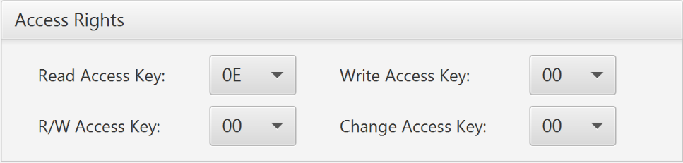

My next questions is regarding "locking" the tag:

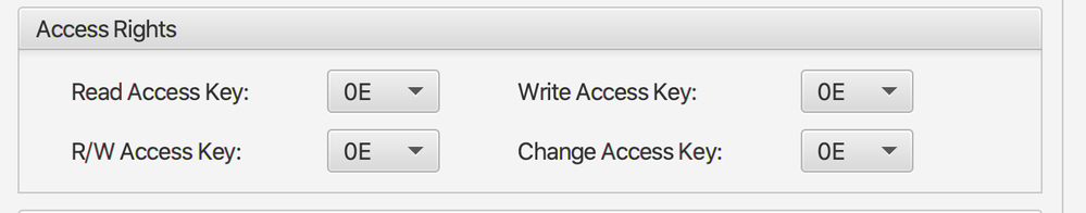

So my tag is now configured and working, it gives me the correct values that my backend accepts for the given two keys. In the last step I want to make sure that nobody can ever read the keys from the tag or change any data in any way to stop the NFC-tag from working, so I want to prevent any data/key changes to the tag.
is it enough to do the following, as you described in your reply above:
or should i also change here some values, since they are all set to 0E.
So once again, now that everything is working correctly the goal is to lock the tag and make it impossible for anyone to change data and keys again or read any of the keys ever again, since its meant to be used as product authentictiy solution.

Jonathan_Iglesias
 please make the change on the CC file and set the rights of the  NDEF file you can set it to read as "0E" for free reading access but  would be good you set other access to masterkey so only you have this keys and be able to modify something.
 if you set something to "0F"it means no access.
like the image above.
Jonathan

manuel_mertl
thank you jonathaniglesias
1)
why do we have to leave the Read Access Key set to 0E instead of 00 like the other 3 acces right key here ?
2)
I guess i have to make the change to the CC file as the very last step, correct?
So first setting the 4 access rights like above 0E, 00, 00, 00, then changing the key 00 to something that i dont have to remember because i never ever want anyone including myself to be able to change data again, and then do the CC File change?
12,444 Views
Jonathan_Iglesias
1) this is because the main purpose of this is that the phone does not need a specific application to launch the link, any phone can launch a link and the back-end will check the information, if you set this to 00, this means first that there will be  a need on your side to develop an application that activate the card and authenticate with the key 00 and then launch the link, also this is not  recommended because this means your master key will be in an application and that is not safe, either if you set this to any other key number, 01, 02,... having the 0E means that any phone can read this and then launch the link. only read access should be 0E.
2) yes, usually the CC modification is done at the end, after all the NDEF is configured and the keys changed, access conditions, etc. then you change this.
Jonathan

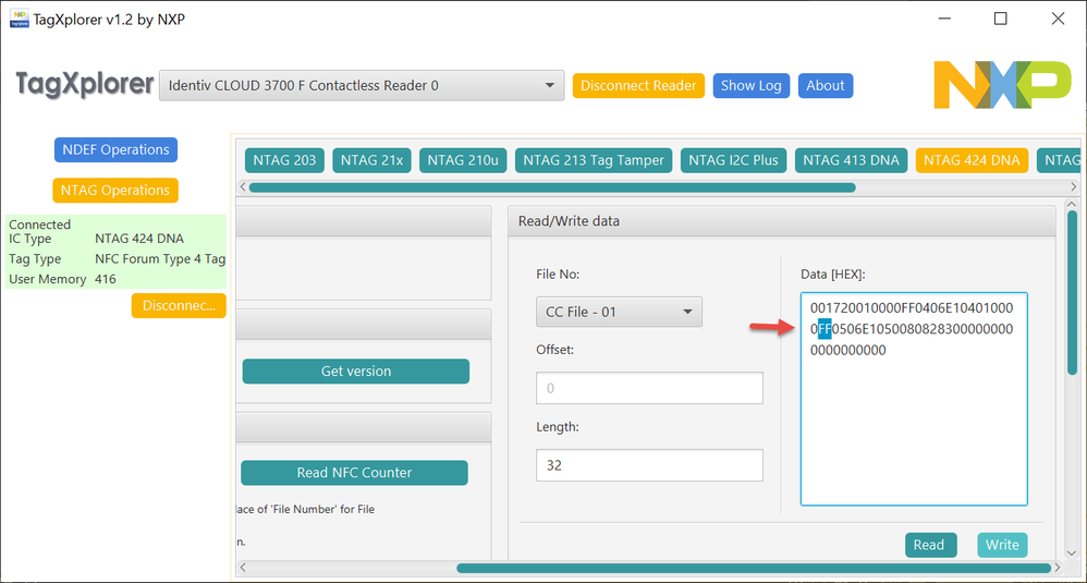

12,444 Views
Jonathan_Iglesias
Hi Manuel,
Hope you are doing great, to change keys you can go to the security management section under NTAG 424 DNA  and below the authentication area there is a change key area, so basically you will need to authenticate with the card masterkey as you can see in the DS pastedImage_1.png
 then  issue the change key command, then you will need to take the take away from the field and put it back again so this changes happen.

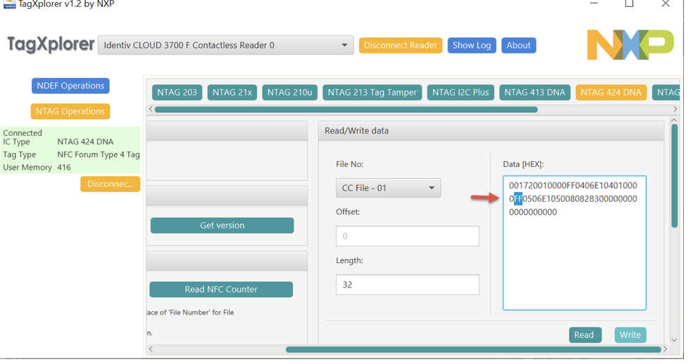

for question 2
the best would be that you modify the Capability container file the E103, if done properly this will put the card in read only mode so the tag can be reader this is done ususally in the same session where you program the NDEF into the NTAG so  after doing the NDEF configuration stated in previos threads,  you will need to read the CC file to get the value and just modify this into FF ( section 8.2.3.2 https://www.nxp.com/docs/en/data-sheet/NT4H2421Gx.pdf )
and write this, if you are in other session first authenticate like you did in the previous community thread.
hope this helps.

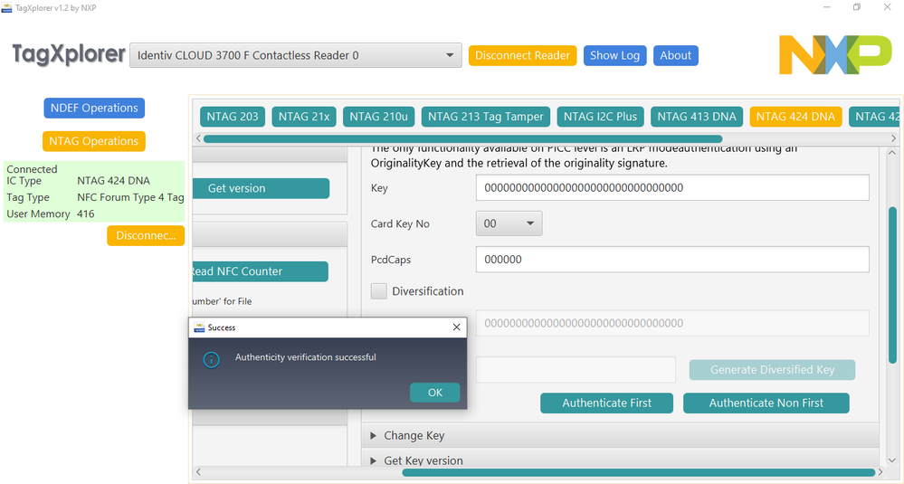

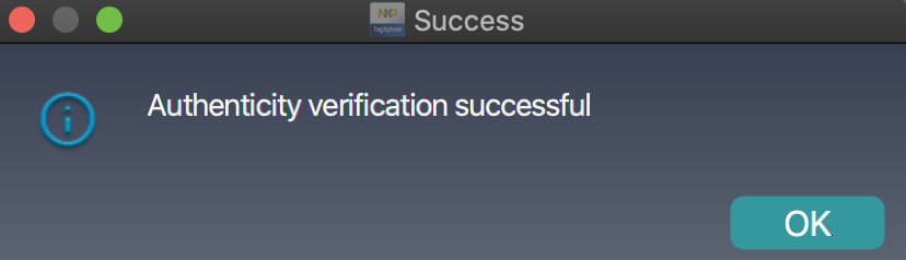

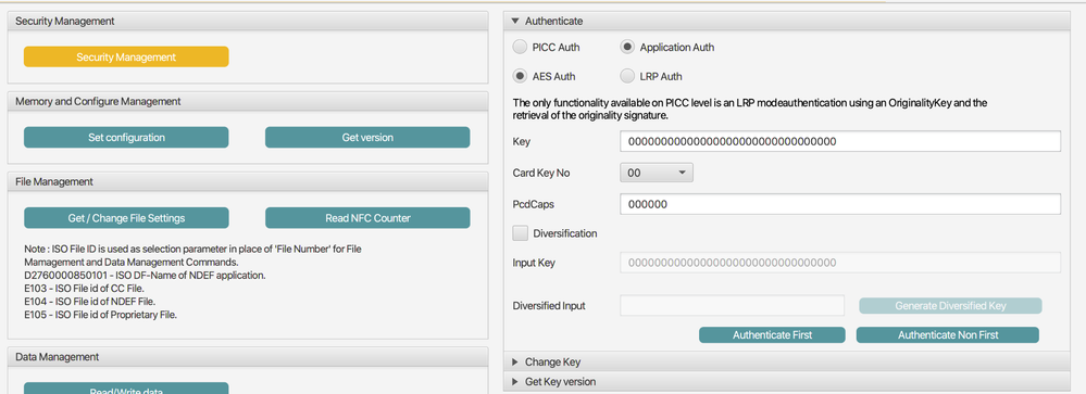

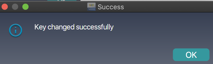

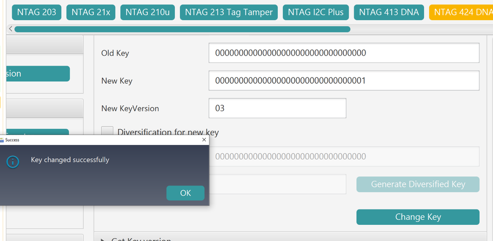

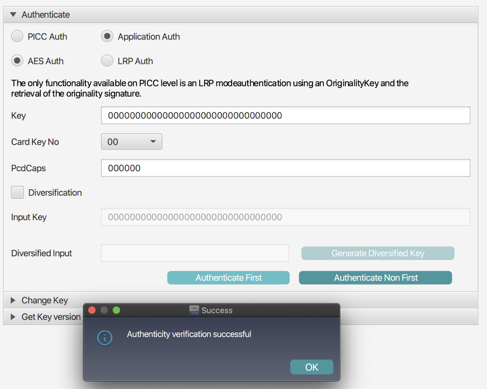

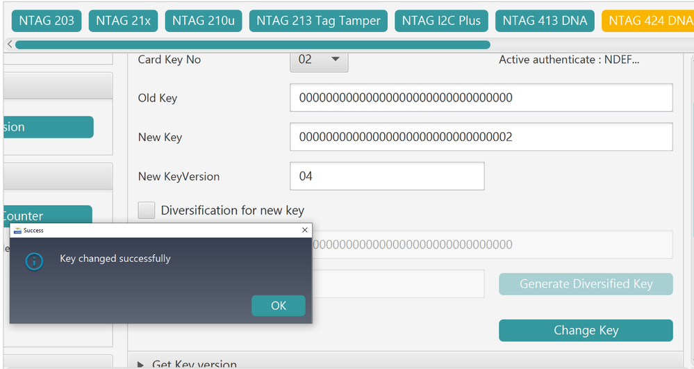

1) I go to "Security Management" and click "Authenticate First"
which prompts me:
2) I go to Change Key and want to change lets say Key 01 and use that as KeyDec thus setting the value 00000000000000000000000000000001 and also set a new version for example 03
which prompts me:
3) then i have to authenticate again
4) I go to Change Key and want to change lets say Key 02 and use that as KeyCmac thus setting the value 00000000000000000000000000000002 and also set a new version 04
but this gives me already an Error: 911E
Thanks, jonathaniglesias
