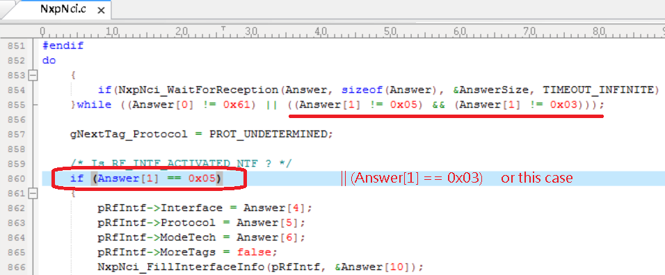

I used NXP Software package is SW3241.zip
I traced the code in NxpNci.c
It seem did not have case when i2c receive is
Answer[0] == 0x61
Answer[1] == 0x03
in "bool NxpNci_WaitForDiscoveryNotification(NxpNci_RfIntf_t *pRfIntf)"
Any idea for it  ?

Yes, I had read 17 bytes.   Sorry, I made mistake in printf.
My question is
the code check condition "((Answer[1] != 0x05) && (Answer[1] != 0x03))" in while loop.
but in below just allow "if (Answer[1] == 0x05)" case.
so could I change to "if (Answer[1] == 0x05) || (Answer[1] == 0x03) "   ??

Kan_Li
Hi Peter,
No, you need not do that, as the else condition includes the case of "Answer[1] == 0x03".
Kan

Kan_Li
Hi Peter,
Looks like the NCI message is not complete, for 61 03 frame, it is expected to have 17 bytes. for example,
[NCI][NOTIFICATION][61 03 0e 01 05 00 09 04 00 04 b0 8c d0 72 00 00 00]
   RF_DISCOVER_NTF
      * RF Discovery ID        = 1 [0x01]
      * RF Protocol            = {Std} PROTOCOL_NFC_DEP [0x05]
      * RF Technology and Mode = {Std} NFC_A_PASSIVE_POLL_MODE [0x00]
      * Length of RF Technology Specific Parameters = 9 [0x09]
      * RF Technology Specific Parameters = [0x04 0x00 0x04 0xB0 0x8C 0xD0 0x72 0x00 0x00]
         --> SENS_RES                = [0x04 0x00]
         --> NFCID1 Length           = 4 [0x04]
         --> NFCID1                  = [0xB0 0x8C 0xD0 0x72]
         --> SEL_RES Response Length = 0 [0x00]
         --> SEL_RES Response        = []
      * Notification Type      = Last Notification [0x00]
Kan
