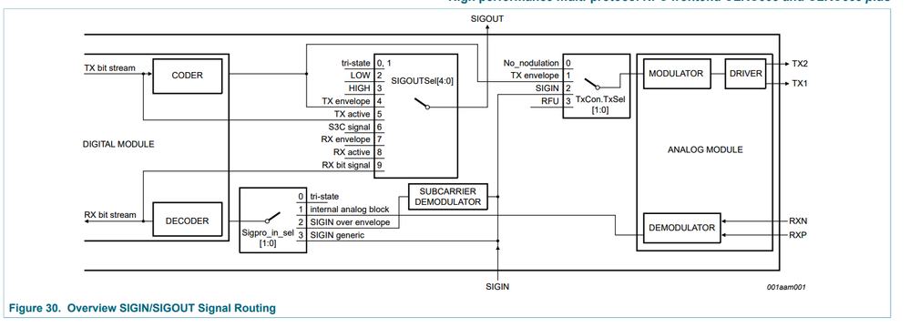

i want to use 2x CLRC663 to make my own wireless data transfer.
I understand that SIGOUT can output RX_active signal and SIGIN can be used for external signal:

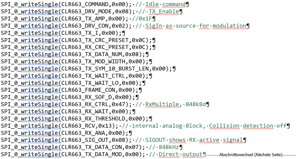

I program the CLEV6630ARD evaluation board registers with my external MCU over SPI and i could measure the NFC Modulation on the TX Pins. I have a Pulse generator connected to SIGIN and at SIGOUT i am watching the RX_active signal.
I am expecting to have the same pulse signal on SIGOUT that i have on SIGIN, but that is not the case.
Am i missing something or RX_active is not the real analog output from the DEMODULATOR?

michaelliesenbe
Hi Estephania,
here is how i wrote the registers:
1- Is it possible to use only the analog side of CLRC663? Using the Analog TX and Analog RX with my own coding on external MCU?

i want to use the Analog Front End from the CLRC663 and bypass the digital part using the internal multiplexer, is this possible?
Because the active RX output is not what i expected.
Here is a diagram showing the way i would like to use the CLRC663:
Michael

estephania_mart
Sorry, the implementation you want to achieve it's not supported.
Sorry for the inconveniences this might cause you .
