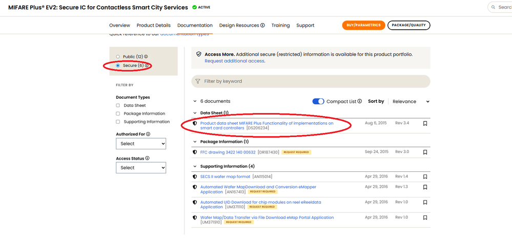

However, I could not find any official NXP documentation that explains:
How to derive the session key from the authentication responses
The exact structure of Read (0x31) / Write (0xA1) commands for MIFARE Plus EV1 in SL3

jimmychan
The details is in the full datasheet. You can download it in the "Secure" file.
