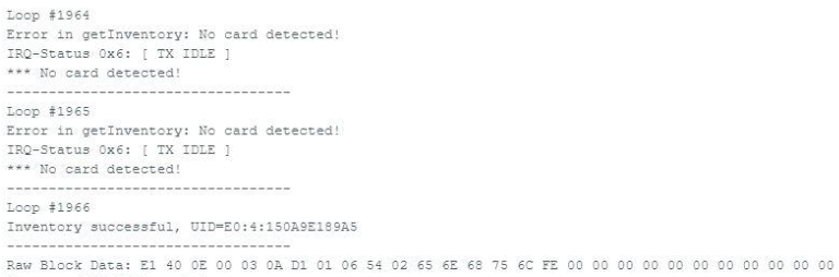

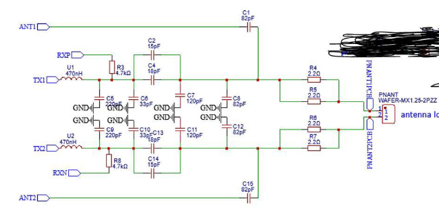

Issue - The current detection range of the I CODE SLIX tag using a PN5180-based antenna setup is limited to approximately 1 cm. This reduced range may be attributed to the antenna tuning
circuit. I have uploaded the PN5180 schematic, the antenna tuning circuit, and a link to the
antenna used for your review.
PN5180 SCHEMATIC
CURRENT CONFIGURATION FOR MATCHING ANTENNA TUNING CIRCUIT SCHEMATIC

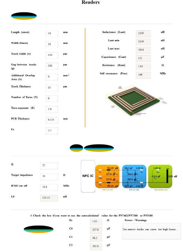

Got the suggestion from NXP for matching antenna tuning circuit from the this website
https://community.nxp.com/t5/NFC/bd-p/nfc
Can I follow this configuration?

vincentthivent
Your antenna is tuned for 50Ohm, so you need to modify your circuit to have a resistive output on the PN5180.
VIncent
598 Views
inhlanzii
Yes , antenna is tuned to 50 ohms . Can you provide some suggestion in modifying the circuit ?
