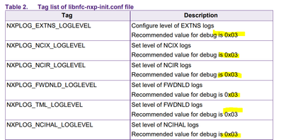

Tomas_Parizek
Hello  Jitendra_thakare,
can you please share your configuration files, please?
  • libnfc-nxp-init.conf
  • libnfc-nxp-pn548.conf
Can you also check if you have all LOG levels set to 03h, please?
After you enable them, please share the logs again. It will help us more understand the issue.
Tomas

jitendra_thakare
Hi Tomas,
I have kept the log level at 0x03, and the board has been on for three days.
I haven't observed any issues during this time. I have also noticed the following logs,
but the RFID is still being detected.
Added Patch.
