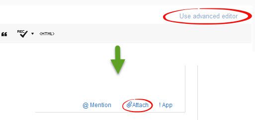

I am not aware of such issue with a "D" (I guess you mean the ASCII character). If you could attach a CSV file to recreate the issue that would be helpful. To attach a file you can click on "Use advanced editor" and then on "Attach" when repying:
