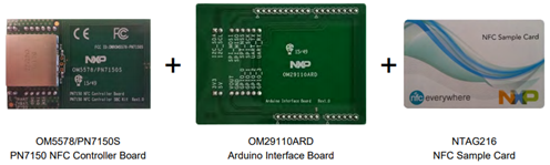

Hardware requirements:pastedImage_19.png
Using PN7150 with LPC55S69-EVK:pastedImage_36.png
Hardware Connections:
The hardware connections are simple. Both the LPC55S69-EVK board and OM5578/PN7150ARD board have an Arduino interface. So, mount the PN7150ARD board with male Arduino connector onto the female Arduino connector of the LPC55S69-EVK board.

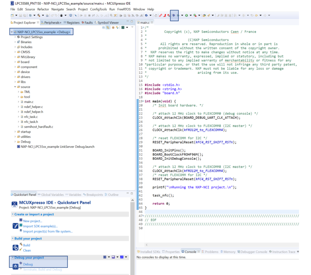

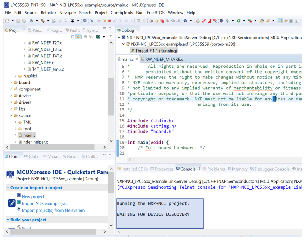

  4. Now that the package has been imported to the MCUXpresso IDE (via drag and drop), click on Debug icon from the Quickstart panel to begin a debug session. Once the debug session has started, click on the run icon to run the code:

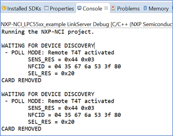

  5. The project should be running now. The project contains basic discovery loop functionality. Here is how the output looks in the console tab on MCUXpresso:
Bring any NFC card near the PN7150 board’s antenna and the output console will show the detection and type of the card. For example, in the picture below, we can see that type 4 card was detected:
