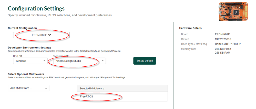

The released NXPNCI-KDS_Example_KSDK2.2 is based on FRDM-K64F, so before porting, we need to configure and download KSDK 2.2 for FRDM-K82F.
Please make sure you have selected Kinetis Design Studio before downloading.

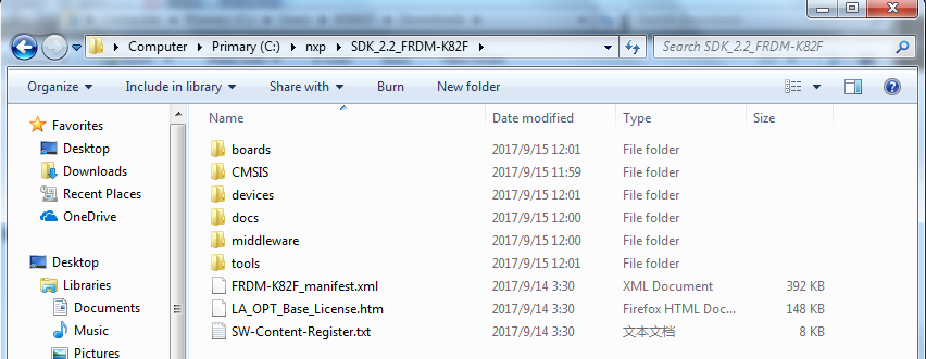

After downloading, extract the package to some folder like below:

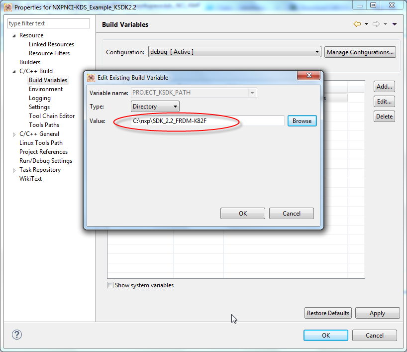

and change PROJECT_KSDK_PATH to this folder:

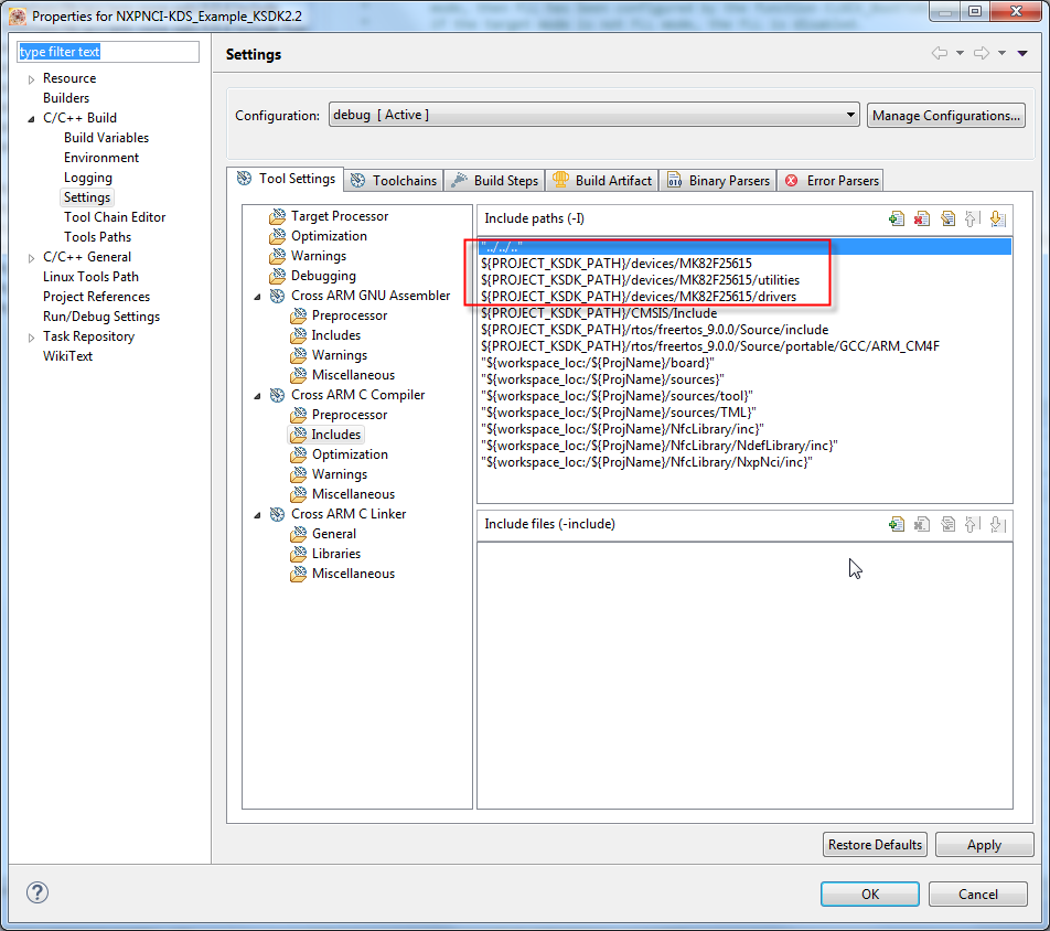

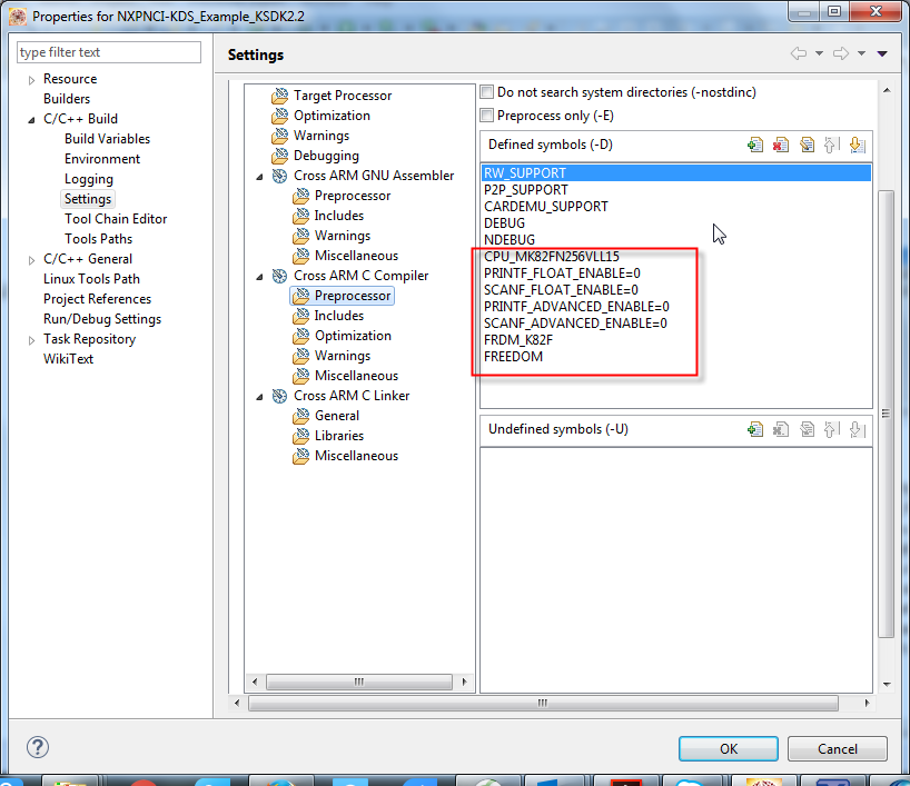

Change project settings as below:

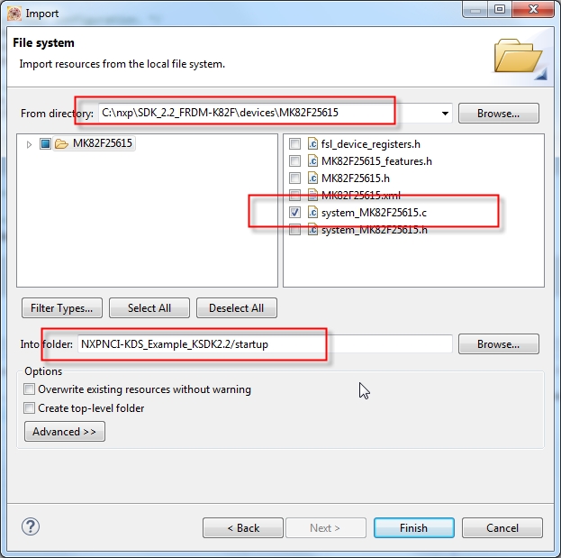

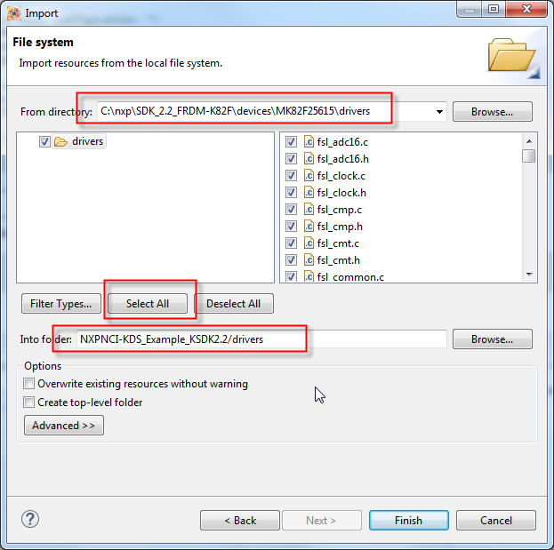

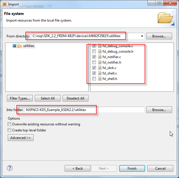

Remove all files in the folder of drivers, and import new source files as below:

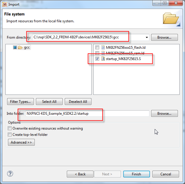

and similar procedure for "startup" folder and "utilities" folder:

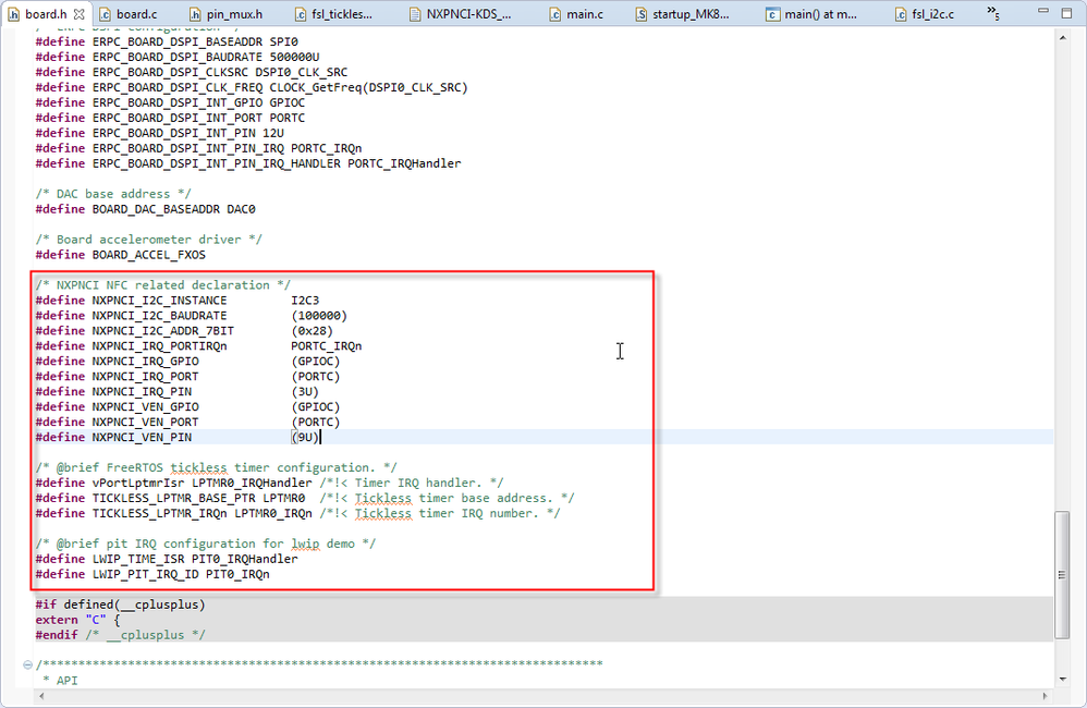

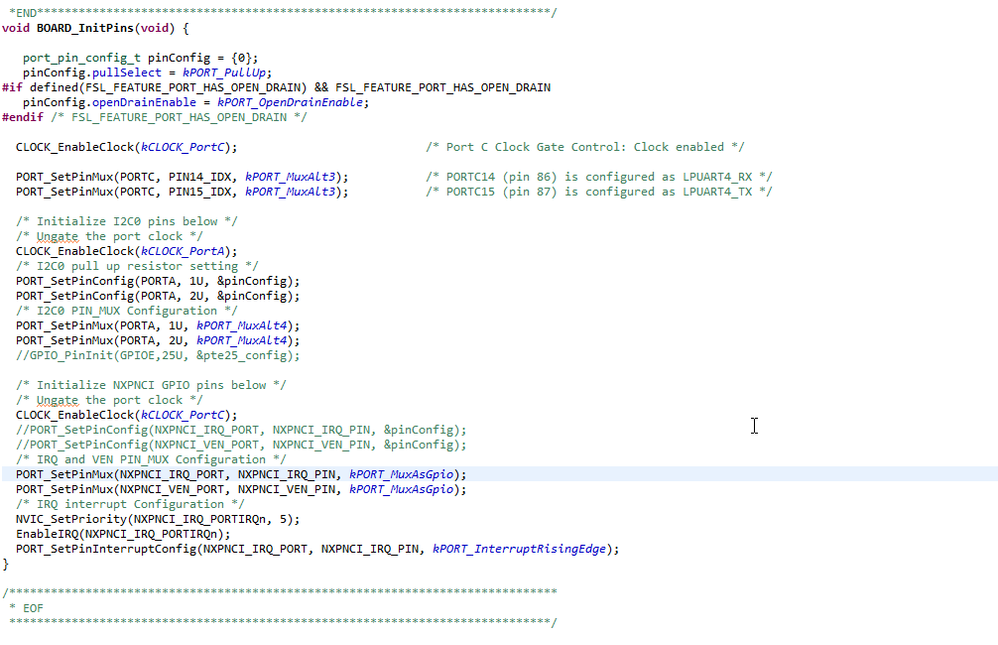

FRDM-K82F uses PTC3 for NCI_IRQ pin, PTC9 for NCI_VEN pin, and PTA1 and PTA2(I2C3) as the I2C interface. so add definition in board.c and modify BOARD_InitPins() as below:

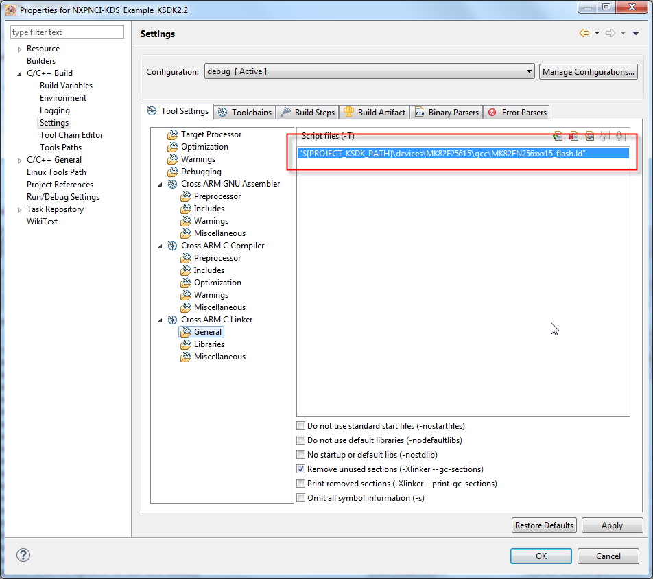

Change linker settings:

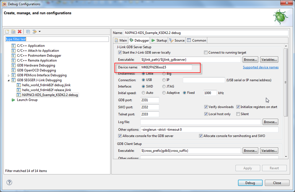

-Debug settings

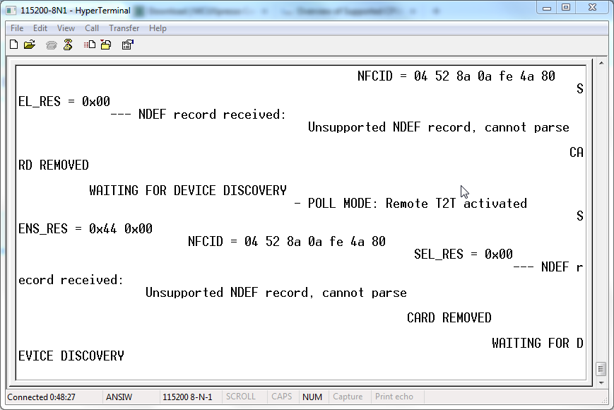

-Test Result:
