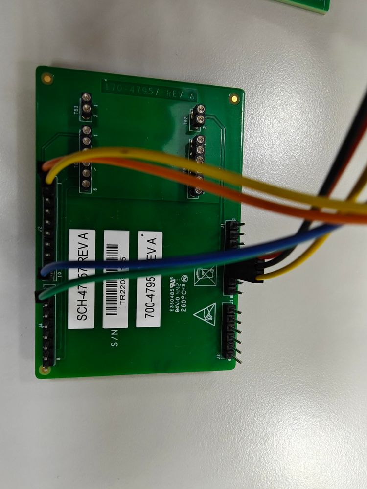

Hardware boards:
i.MX8MN EVK (i.MX 8M Nano Evaluation Kit | NXP Semiconductors)
PN7160 EVK (OM27160| Development Kits for PN7160 Plug'n Play NFC Controller | NXP Semiconductors)
The connection between i.MX8MN EVK and PN7160 OM29110ARD-B
i.MX8M Nano EVK
pin
PN7160
pin
3.3V
J1003-1
VDD(3.3v)
J1-4
5V
J1003-2
VBAT (5v)
J1-5
I2C3 SDA
J1003-3
SDA
J2-2
I2C3 SCL
J1003-5
SCL
J2-1
GPIO3_22
J1003-37
IRQ
J2-10
GPIO3_21
J1003-38
REQ
J4-2
GND
J1003-39
GND
J1-6
GPIO3_20
J1003-40
VEN
J4-1

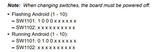

Build the Android for i.MX8MN EVK
The i.MX Android BSP that I used is Android 15.0.0_2.0.0 (L6.12.20_2.0.0 BSP). It could be downloaded from here: Android OS for i.MX Applications Processors | NXP Semiconductors
1. Download the "Documentation" and the "Install Source Package".
2. Follow the steps in Android User's Guide to build the Android BSP for i.MX8MN EVK first.
According to the android_build/.repo/manifests/aosp-android-15.0.0_2.0.0.xml, you will see the AOSP version is android-15.0.0_r32.

9. Download the image to the i.MX8MN EVK board
- Switch to download mode on the 8MN EVK board
- Download the Android 15 BSP i.MX8MN EVK demo image from the Android BSP web page first. Because there are UUU script and necessary image files already in the demo image package.
- Download the UUU from here : Releases · nxp-imx/mfgtools
- Put the UUU executable file into the demo image folder. uuu_imx_android_flash.bat is the script also in the same folder.
- After your building is succeed, Copy the images to the demo image folder. The images are located in android_build/out/target/product/evk_8mn/
- Run the UUU script to download the images to the EVK board.
