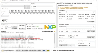

In case of PN5190, the NFC cockpit can only show a generic error messages. More detailed error description has to be decoded from the received "FrontEnd Packets"
1. See an example of the error returned after ULPCD calibration
2.  The Errors description is descibred in  PN5190 instruction layer UM. However, the error has to be "decoded"

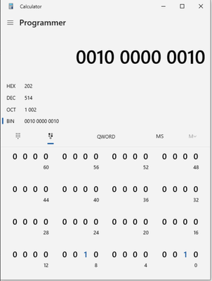

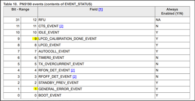

2.1. Decode the "Event"
02 02 (Little endian format) → General_Error_Event + LPCD_Calibration_Done_Event

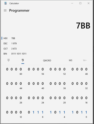

2.2 Check LPCD_CALIBRATION_DONE_EVENT
07 BB (Little endian format) → Measured RSSI Value
Tomas_Parizek_4-1744178146251.pngTomas_Parizek_4-1744178146251.pngTomas_Parizek_5-1744178162257.pngTomas_Parizek_5-1744178162257.png

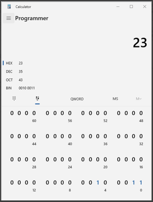

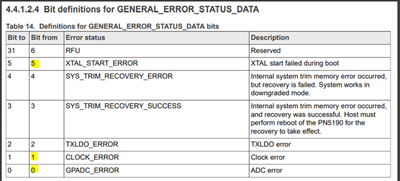

2.3. Check the GENERAL_ERROR_EVENT
 00 23 (Little endian format) → Definition of the general error event → Error is : GPADC_ERROR, CLOCK_ERROR and XTAL_START_ERROR
