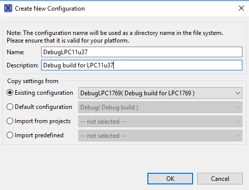

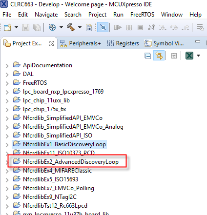

Now, it is time to port other demos in this project. You may choose any demo, but here NfcrdlibEx2_AdvancedDiscoveryLoop is selected.

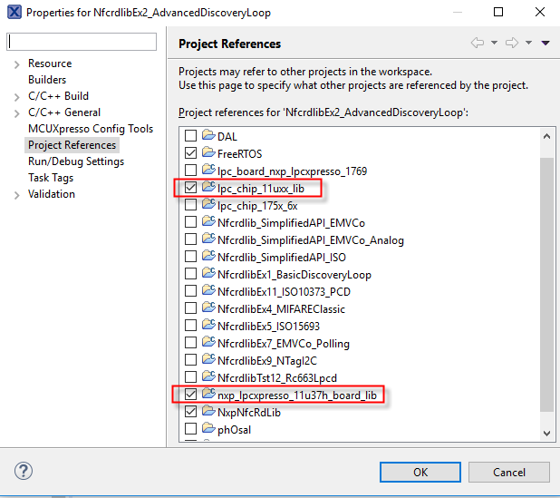

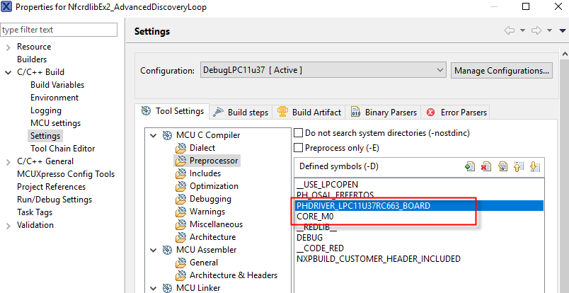

and similar with before, the first step is creating a new build configuration:

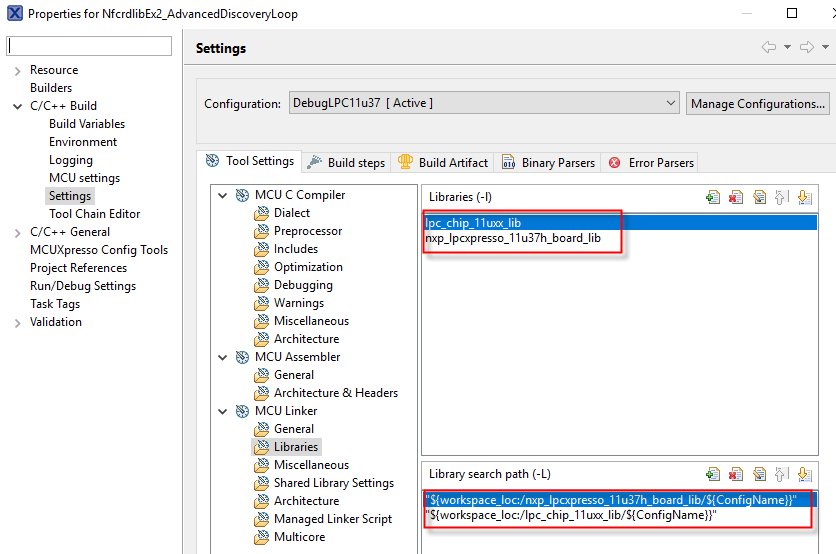

then in the project references, choose the LPCopen library for LPC11u37 instead.

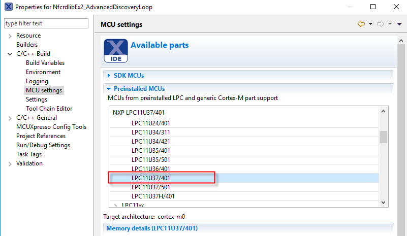

Change the MCU settings:

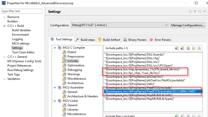

Change the build settings:
Change FreeRTOS portable to cortex M0:

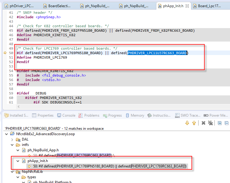

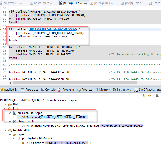

Search "PHDRIVER_LPC1769RC663_BOARD" in the source code of "NfcrdlibEx2_AdvancedDiscoveryLoop" project, and you may simply replace it with "PHDRIVER_LPC11U37RC663_BOARD", and there are only two places needs to be fixed.

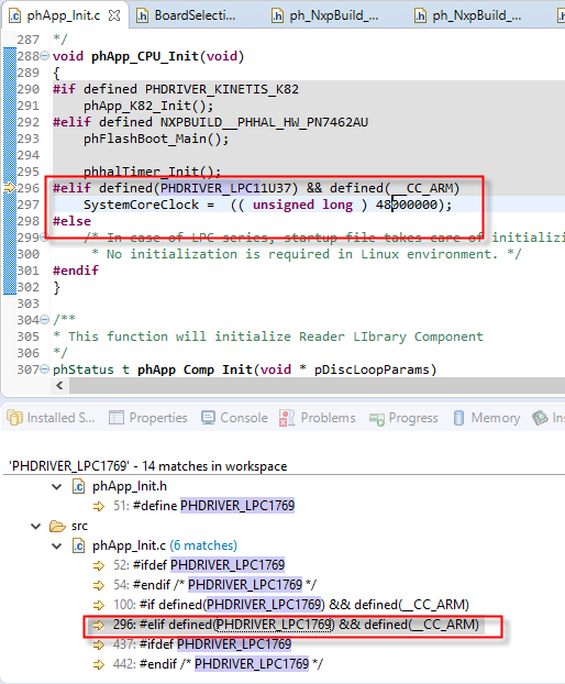

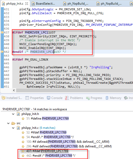

Search "PHDRIVER_LPC1769" in the source code of "NfcrdlibEx2_AdvancedDiscoveryLoop" project, and you may simply replace it with "PHDRIVER_LPC11U37". Most changes are in phApp_Init.c.

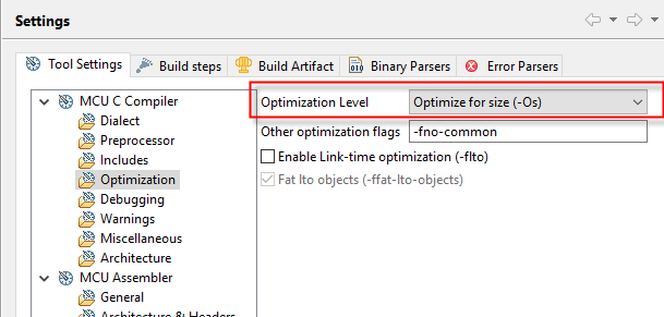

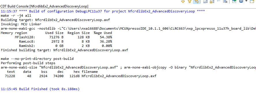

Also please don't forget to enable optimization for size.

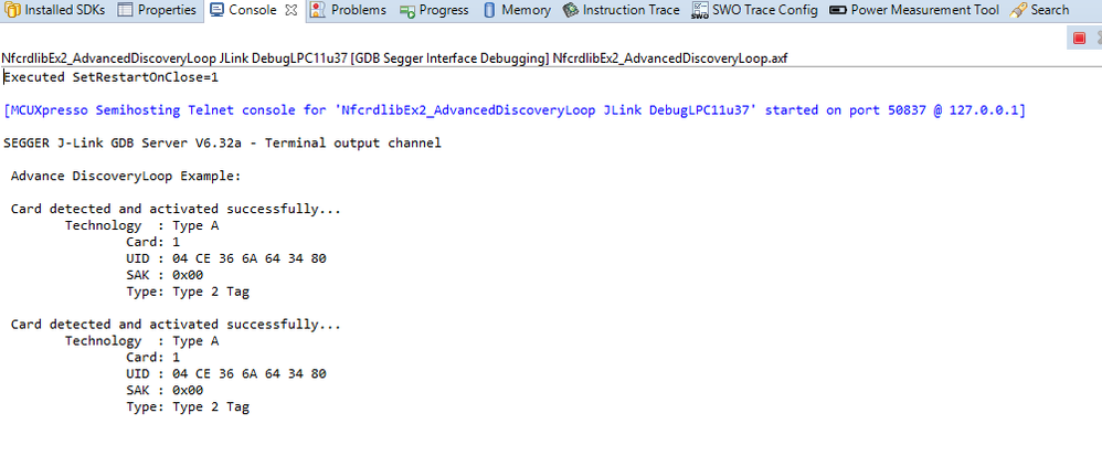

Building result:
Demo testing result:
