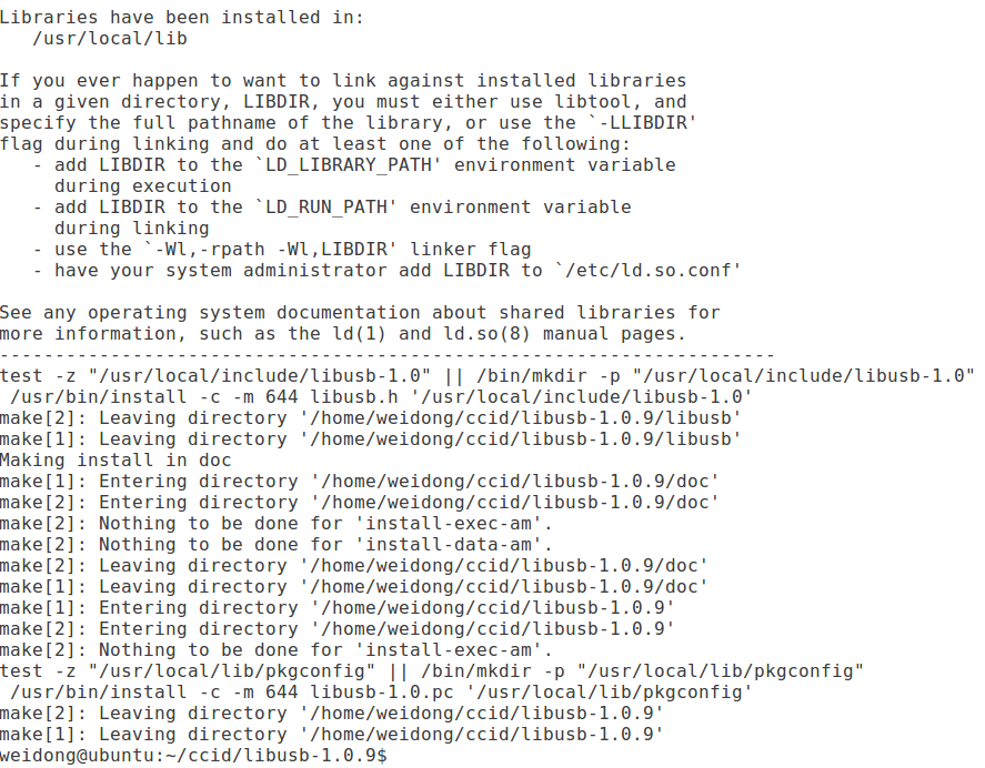

1. libus installation
(1) Download it from : libusb
File name is libusb-1.0.9.tar.bz2
(2)Decompressing it
# tar jxvf libusb-1.0.9.tar.bz2
# cd ~/ccid/libusb-1.0.9
# ./configure
# make
# sudo make install

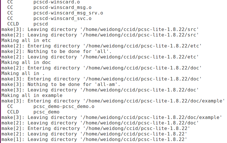

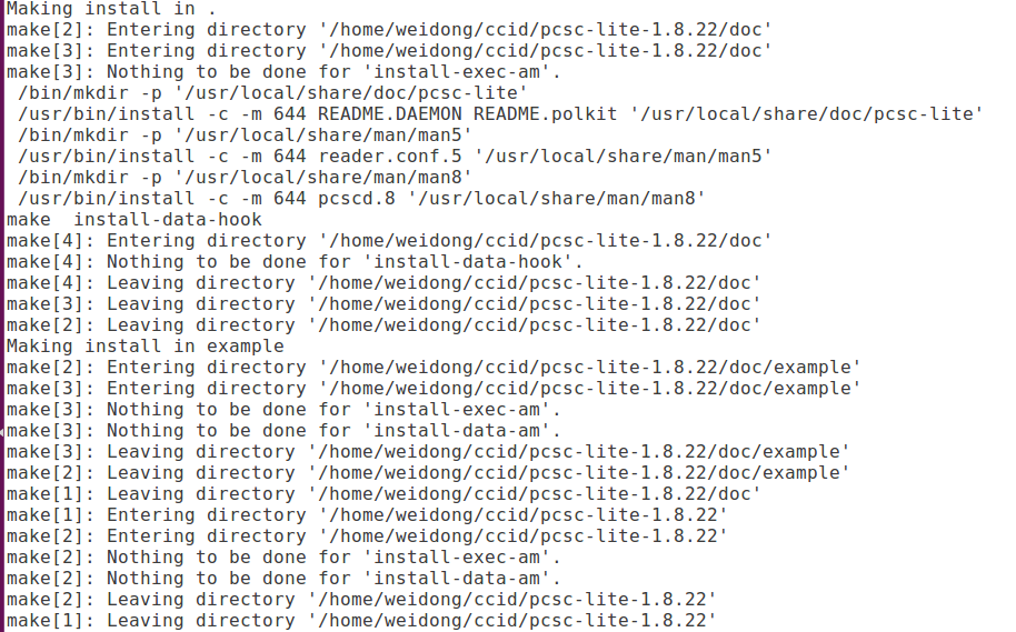

(3) compiling it
# cd pcsc-lite-1.8.22
# ./configure
# make
# sudo make install

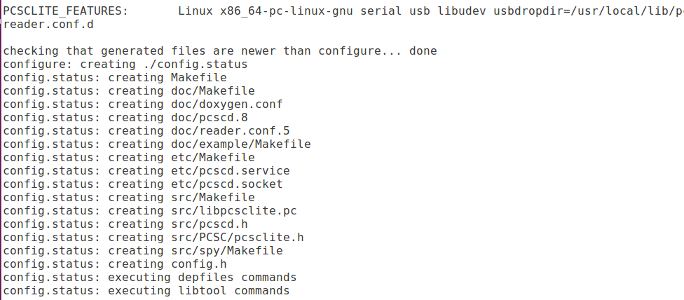

# ./configure
After runing configure command, information below will be displayed:

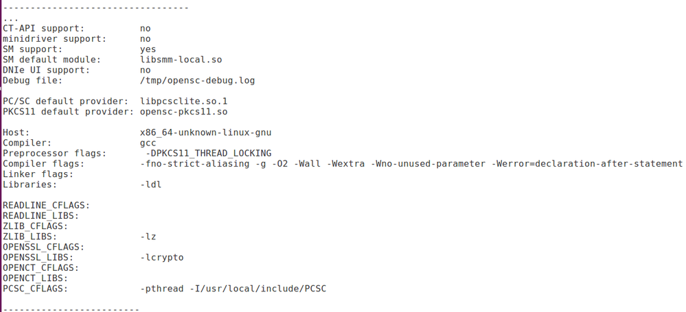

4. opensc installation
(1) Downloading it from : OpenSC - Browse /OpenSC/opensc-0.16.0 at SourceForge.net
File name is : opensc-0.16.0.tar.gz
(2) Decompressing it
# tar zxvf cd opensc-0.16.0.tar.gz

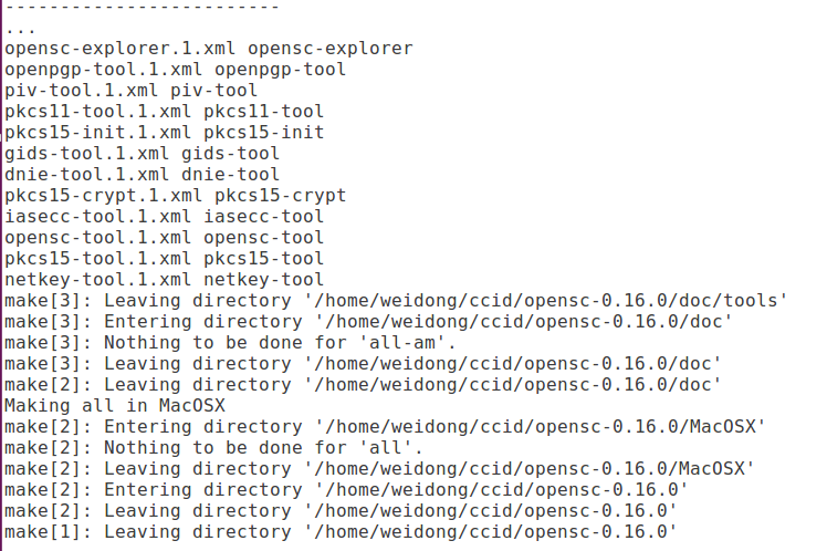

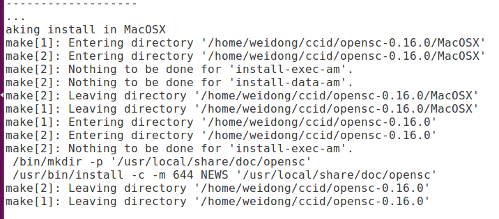

(3)Compiling it
# cd opensc-0.16.0
# ./configure --enable-openssl --enable-pcsc
# make
# sudo make install
Up to now, above 4 software packages have been installed to ubuntu 16.04 LTS.
