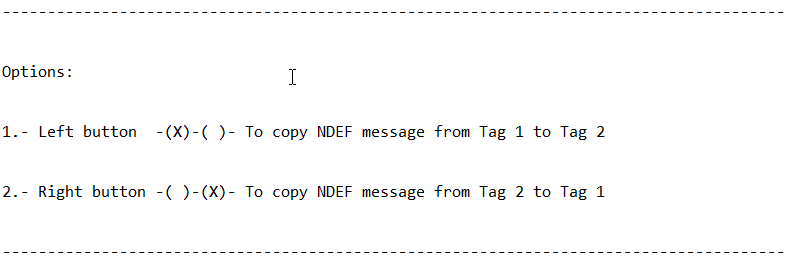

                DEBUG_PRINTF (" \n --------------------------------------------------------------------------------------- \n\n");
                DEBUG_PRINTF (" \n Options: \n\n");
                DEBUG_PRINTF (" \n 1.- Left button  -(X)-( )- To copy NDEF message from Tag 1 to Tag 2 \n\n");
                DEBUG_PRINTF (" \n 2.- Right button -( )-(X)- To copy NDEF message from Tag 2 to Tag 1 \n\n");

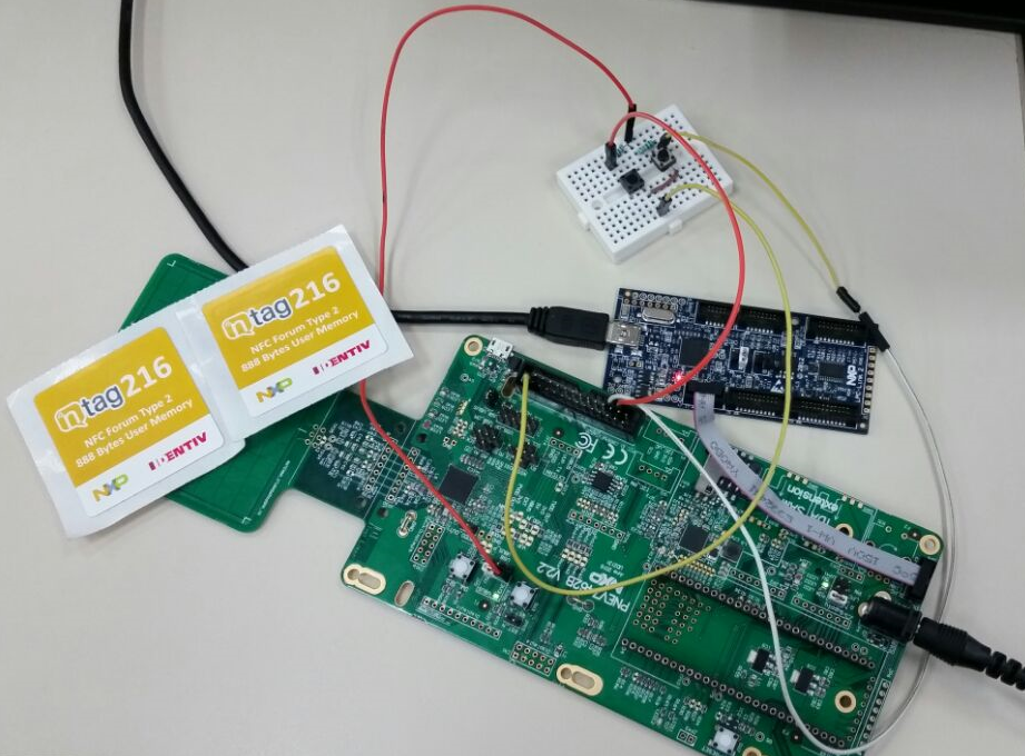

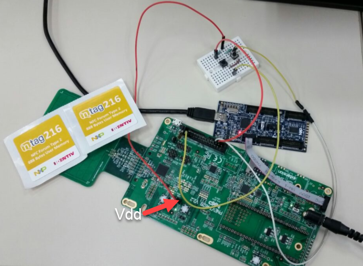

Hardware configuration section:
For the Hardware set up, two push buttons will be connected to GPIO_2 and GPIO_3 of PNEV7462B as follows.
Vdd will be connected to 3V3 pin on the board:
GND can be connected to any GND on the board.

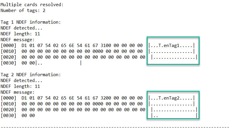

Each tag was previously written with a text NDEF message respectively.
Tag 1:
Text: Tag1
Language: en
Tag 2:
Text: Tag2
Language: en
Writing to a tag can be done by making use of our TagWriter app available in the play store:
NFC TagWriter by NXP - Aplicaciones de Android en Google Play
  • First both tag's NDEF text messages will be displayed:
  • Once the information is read, you'll be asked to select an option from the following menu:

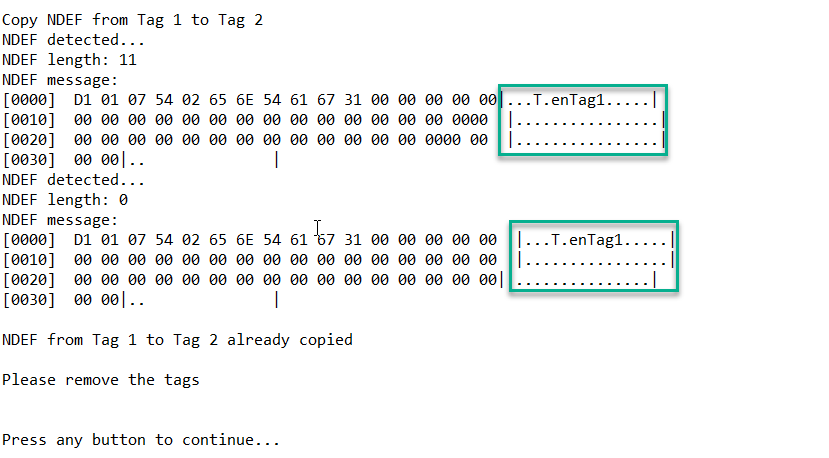

  • If left button (GPIO_2) is pressed, the content from Tag 1 will be written to Tag 2:

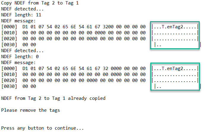

  • Otherwise, If left button (GPIO_3) is pressed, the content from Tag 2 will be written to Tag 1:
