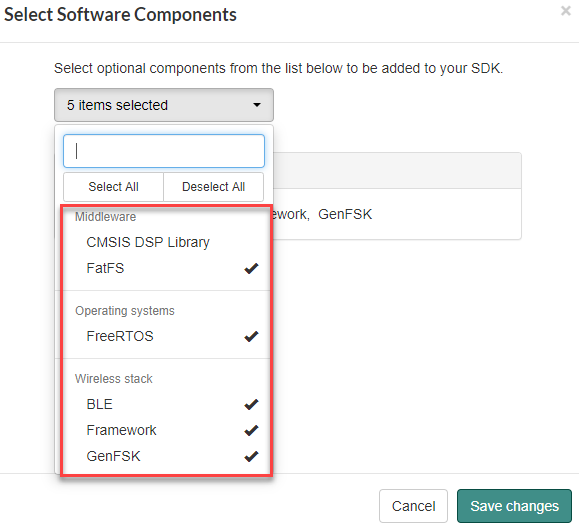

Download SDK as mentioned in chapter 2.1.3 of KW41Z User Manual and pay close attention to include NTAG I²C middleware.
Now, repeat the same procedure above for FRDM KW36, this will be the SDK on which we will be making the modifications for the porting.
NOTE: Unlike KW41Z, for KW36 there is no NTAG I²C plus middleware as shown in the image below:
Save changes and build the SDK. NTAG I²C middleware will have to be imported from KW41Z's SDK in MCUXPresso.

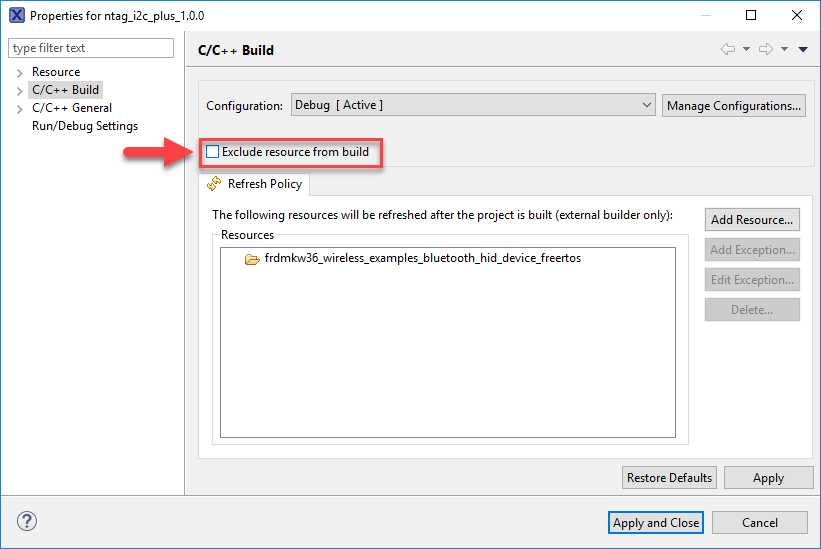

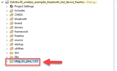

Copy ntag_i2c_plus_1.0.0 folder from KW41Z workspace to KW36's
Open folder properties and uncheck Exclude resources from build, then apply and close.

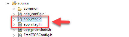

Copy app_ntag.c and app_ntag.h files from KW41Z  workspace to KW36's.
The app_ntag.c source file contains sample functions for working with NDEF messages. Function NFC_MsgWrite() creates and writes the NDEF message in the Type-2 Tag format to the NTAG I2C chip through the ntag_i2c_plus middleware. The write algorithm is NFC-Forum compliance. Function NDEF_Pairing_Write() contains a procedure to create a BTSSP record via using the NDEF library. The same is performing function NDEF_Demo_Write() function. Here is shown how to create NDEF multi-record that contains several types of NDEF records.
The app_ntag.h header file contains predefined blocks of constants (constant fields of data) that are written to the NTAG I2C chip by default during the communication which requires set the default content to the chip’s registers or erase the NTAG I2C chip user memory and registers of lock bytes.

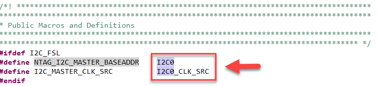

NOTE: Please change the I²C Master base address and I²C Master clock source from I2C1 to I2C0 as below in app_ntag.h:

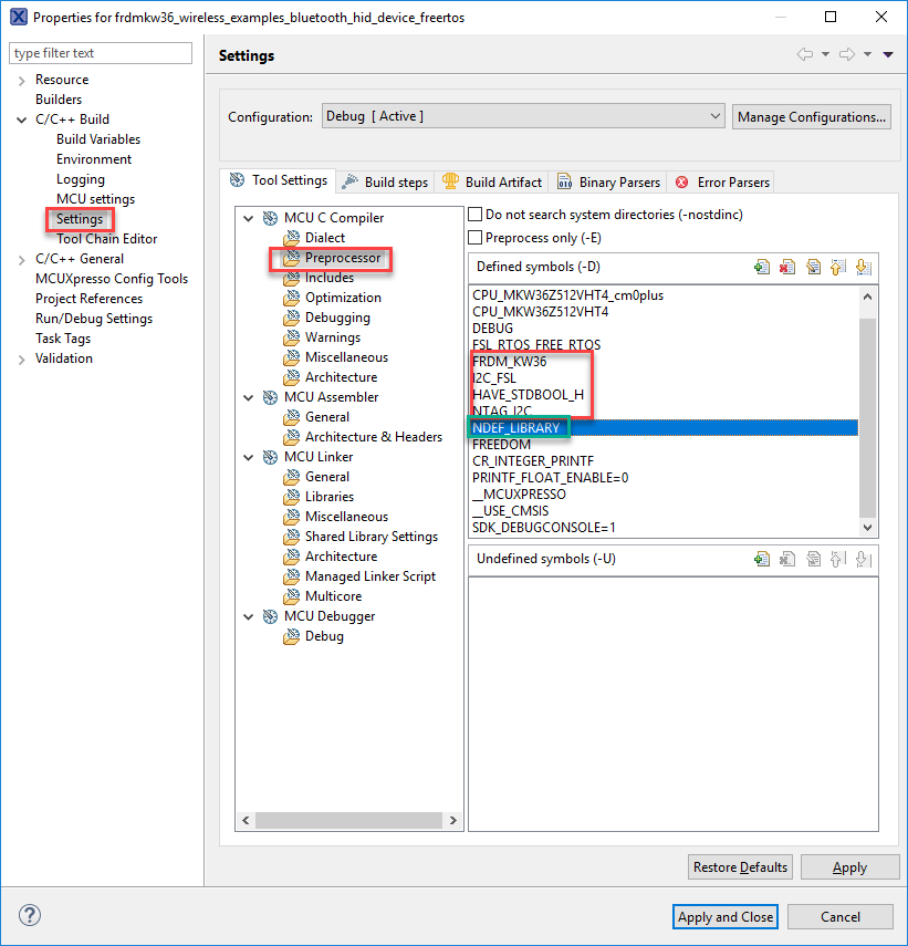

Symbols
Add the following symbols to project settings -> Preprocessor. The ones in red are for integration of ntag_i2c_plus middleware and the one in green is for adding the NDEF library, please see below:

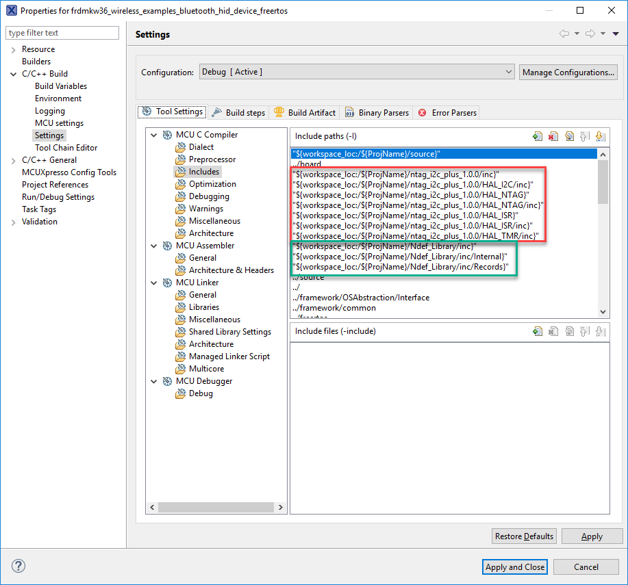

Include paths
Please add the following includes in project settings. The ones in red are for NTAG I²C Plus middleware and the ones in green for the NDEF Library, please see below:
