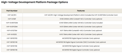

Hello, I am an electrical-electronics engineering student and I want to improve my knowledge about motor drivers. I have a few questions regarding the HVP-MC3PH motor driver kit:
  1. Besides the control board included in the kit, which other control boards are supported?
  2. Which microcontrollers (MCUs) are supported for sensor-based and sensorless FOC?
  3. Which interface is used for programming?
  4. Is there any software available to monitor output voltage and current graphs on a computer?

Please refer below pictures about HVP-MC3PH high-voltage development platform supported microcontrollers:
Related Microcontroller cards listed below:
The debug and program interface based on microcontroller core type, in general most supported MCU based ARM Cortex-M core. Related debug interface is SWD/JTAG.
PEmicro Cyclone programmer  would be a better option for standalone programmer.
NXP FreeMaster tool is a real-time debug monitor and data visualization tool. More details please check here.
Please visit here to get more resources about HVP-MC3PH Kit.
