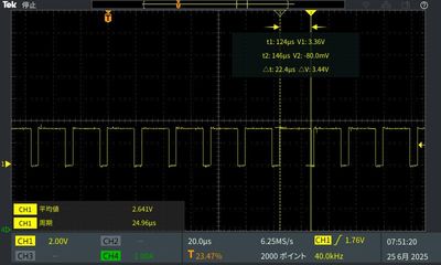

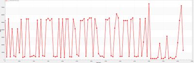

Tomato1

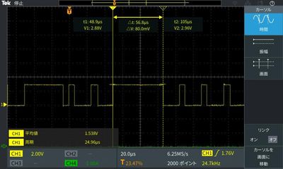

The value of the counter variable "g_ui32NumberOfCycles" was graphed using FreeMaster. Additionally, I switched the IO output at the beginning and end of the function ADC_ETC_IRQ0_IRQHandler() and captured the waveform with an oscilloscope. The carrier frequency is 40 kHz. The "Link application to RAM" option is not checked (left at default). 
I also captured the waveform with an oscilloscope on the S32K344. While the processing finishes in about 20 to 22 microseconds with nearly identical values, the RT1170 shows a significant variation, taking between 5 to 56 microseconds. I feel that the interrupt processing settings may not be correct, but I would like to understand why this phenomenon occurs with the RT1770. Please provide guidance on the cause and possible solutions.

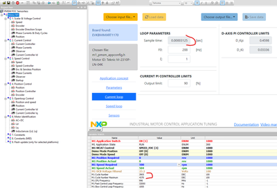

joseftkadlec
Hi @Tomato1 ,
I tried your example on my desk. Just for clarification, I have RT1170-EVKB and Teknic M-2311P. It is not exactly the same setup as you are having but for the CPU load issue investigation should be OK.

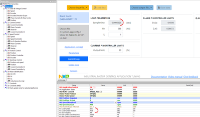

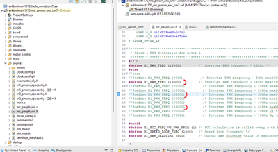

I tried 3 frequencies from your mc_periph_init.h (16kHz, 32kHz, 64kHz):
Then I started Freemaster with MCAT, I could see a change in Sample time (62.5us, 31.25us, 15.625us). I always recalculated and updated parameters for new Sample time ("Update" button) and spun the motor at 500rpm in sensorless FOC control. I checked the Cycle number:
The Max Cycle number was 4330, 4370, 4365. The cycle number is about constant which is expected, the calculated CPU load grows (x2 x4) with frequency (32kHz and 64kHz).
Which configuration/memory are you using? I was running the example from RAM

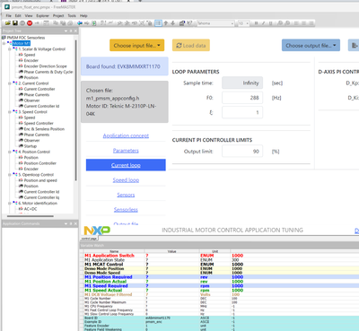

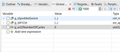

Tomato1
After checking "Link application to RAM,"
I rebuilt and ran the debug.
I can no longer reference the variable values in "freemaster" or "Global Variables."
Is there any other setting that needs to be configured?

Tomato1
This is a supplement.
When I check "Link application to RAM," even if I set a breakpoint in the interrupt handler "ADC_ETC_IRQ0_IRQHandler()," it does not break at all. It seems that the interrupt is not occurring.
Simply checking "Link application to RAM" does not seem to be sufficient for the settings.
Please advise on how to address this issue.

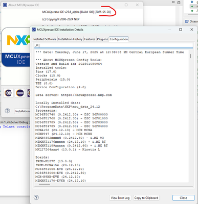

Tomato1

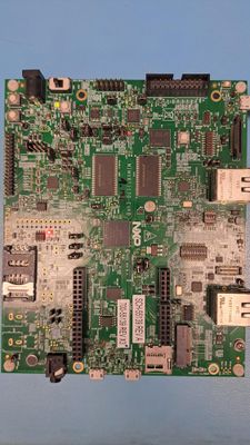

It seems that both the board and the IDE you are using are different versions from mine.
Board: SCH-55139REV C1
IDE: v24.12 (This is the latest version available on your company's website.)
I also removed the FRDM-LV-PMSM and performed debugging, but the situation remains unchanged. The values do not change in FreeMaster or the Global Variables tab.

I forgot to mention one important thing. When the inverter's switching frequency "M1_PWM_FREQ" is set to 16,000, there are no particular issues. However, when it is increased to 32,000 or 50,000, it becomes noticeably unstable (the difference between the minimum and maximum values is more than double).
We are considering increasing the switching frequency and the current control cycle to above 64 kHz.
