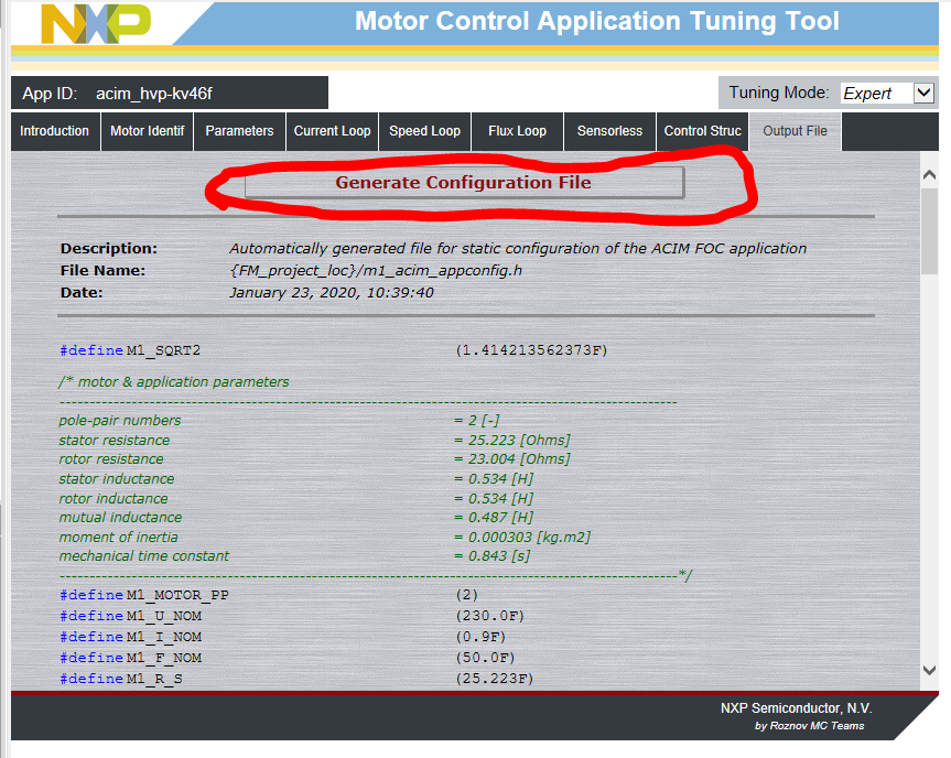

I misunderstand what project do you use. Let's make sure that we are talking about the same thing.
Do you use whole ACIM project from SKD package located in
..\SDK_2.7.0_HVP-KV46F150M\boards\hvpkv46f150m\demo_apps\mc_acim\iar ?
Do you use freemaster file from SDK package located in ..\SDK_2.7.0_HVP-KV46F150M\boards\hvpkv46f150m\demo_apps\mc_acim\acim.pmp ?
Or do you only copy some new project file and freemaster file to old project?
1.  I found that V/Rpm factor is accessible only in "Tuning mode = EXPERT" . Make sure that you have set MCAT in EXPERT tunning mode, becasue in BASIC tunning mode the V/Rpm factor is not accessible.
2. I found that if acceleration parameter is changed then you must click to "STORE DATA" and then switch to "OUTPUT FILE tab" and click to "generate configuration file" (this will generate new m1_acim_appconfig.h file beacause same calculation must be done in MCAT script to correctly set speed ramp) and then rebuild whole SW and load to MCU. Because if you change acceleration parameter and then click to "update_target" then the speed ramp variable in MCU is updated incorrectly.
The "UPDATE TARGET" feature will not be accessible for this acceleration parameter which needs other calculations in MCAT script, this will be fixed in next SDK release.
3. I found that if scalar required speed is set then, speed is ramping up and motor start spinning up (correct behavior). BUT if the speed is set to zero or some fault is generated and then new value of scalar required speed is set, then the speed ramp is not working and the motor is starting directly from zero rpm to required rpm without speed ramp. This is because speed ramp variables are not cleared if the motor stopped from previous run.
I know this is bug, but we will fix it in next SDK release. The workaround is the resetting of MCU  every time if new scalar required speed is set. Or you can fix this bug by adding this lines of code:
g_sM1Drive.sScalarCtrl.fltSpdMeRamp = 0.0F;
g_sM1Drive.sScalarCtrl.sRampParSpdMe.fltState = 0.0F;
and paste it into this function:
static void M1_ClearFOCVariables(void)
which is located in m1_sm_ref_sol.c file.
Try the steps I described. Set the low speed ramp (low acceleration parameter for example 100 rpm/sec) and try it in the way that I described in point 2. and 3.
4. Do you have correctly set pole-pair parameter [pp] for your motor? Pole-pair parameter is crucial parameter.
5. Changing the IN parameter has no effect in scalar mode because scalar mode is open loop control without PI regulators, so the current limit works only in speed FOC mode.
Thanks to you, we were able to find bugs in our software.

try new version of ACIM application at first. You will find it in latest SDK release in motor control middle-ware. Build SDK package for HVP-KV46 board (make sure that motor control component with ACIM application is selected) using SDK builder: Welcome | MCUXpresso SDK Builder .
Fault pending = 1 is over-current fault, there are several reasons for this fault.
  • Phase voltage is 190V, but you have 320V in DC-bus. Did you set correct phase voltage 190V in "Parameters" tab in freemaster?
  • Motor was identified with drum or without drum?
  • Motor identification algorithm enters to second phase: NO-LOAD test?
  • The fault occurs when the motor starts to spin or during the spinning?

I suspect this motor is more powerful because of low Rs and Rr. NXP power stage is designed for 8A, this is maximal measurable current with current sensor. You should not change the Imax parameter, because this parameter is the current sensor scale. If you change Imax to 10A then the value of measured current will be incorrect because the NXP power stage can physically measure max 8A.
But over-current fault is set by power-module. If the phase current reach 10.5A, then the over-current fault is set by HW.
You increased Pn and the motor ran longer, this is because slower voltage ramp is used for motor start-up in the case of bigger Pn. Powerful motors with low resistance Rs must have slow voltage ramp with small voltage increments, because if the voltage ramp is too fast, then higher value of voltage is applied to the motor what causes that the current reach higher values then 10.5 amps for short time, but this phenomenon triggers the HW over-current fault. This problem can be solved by slowing down the voltage ramp.
I suggest to try scalar control, this is open loop control without feedback. You can try this scalar control, but try it with slower speed ramp (you can change speed ramp (acceleration) in speed loop tab in freemaster) I think that you must click to "generate output file" in output tab and download SW with new parameters into MCU.
If slowing down the speed ramp does not solve the problem, then you can lower the minimal voltage Umin which is applied to the motor in start-up in scalar mode. You will find it in m1_acim_appconfig.h file variable M1_SCALAR_U_MIN  (25.0F) and play with V/Rpm factor (you will find it in control struct tab and you can tune it online) until the motor can run in scalar mode without fault.
The correct behavior of scalar mode is essential because the motor identification algorithm uses scalar control to spin motor and measure power in no-load test. If the scalar mode will work properly, then we can try to tune motor identification algorithm. It makes no sense to try motor identification algorithm without the properly functioning scalar mode.
