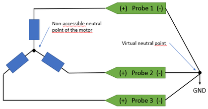

I am following the AN4680 document, which describes the following for calculating Back-EMF. It is stated, "For three-phase measurement if the neutral point is not accessible, it’s possible to create the artificial neutral point from all three voltage probe clips connected together". I did the connection as given below(Fig.1 assuming the Motor has star topology).
Fig. 1
Note: I am working on motor control for Igus MOT-EC-60-CIA (3 phase EC/BLDC Motor,NEMA24) motor using RT1050-EVK-B and FRDM-MC-LVPMSM. 
  1. Motor Parameter
1.1)How to check if the Motor have Star or Delta Topology?
1.2) Does the measured Vpk-pk correspond to phase-neutral or phase-phase voltage?(Unknown: Motor have Star or Delta Topology)
1.3) If it is Phase-Phase Voltage, can it be converted to Phase-neutral voltage by using the following formula,
                    Van= {Vab/sqrt(3)}   ------------------------------------------- [1]

Here are some answers:
1.1) Try the following test:
1.2) At the star topology it corresponds to phase-to-neutral voltage.
2.1)
Undervoltage fault: is triggered when the DCbus volateg drops under a certain level. On FRDM-MC-LVPMSM use 24VDC.
Overcurrent fault: is triggered when DCbus current goes over a certain level. This fault is done using MCU peripheral interconnection: DCbus current analog value is brought to comparator(CMP), CMP output is brought to PWM fault input which can (in case of fault) immediately turn off PWM outputs. Overcurrent fault threshold is fixed and can be changed in code only.
NOTE: Faults in FreeMASTER marked as Captured don't clear automatically and are ON even after the fault condition doesn't apply anymore (it's like a fault history). Must be cleared manually.

Hello @nxf63743,
Answering some questions:
Most of the BLDC motors used the star configuration but if you want to check the confirm this I will suggest looking at the motor documentation.
2.1) What is the reason for the error- "FAULT: Under Voltage" and "FAULT: Over Current" in the FreeMASTER?
In the code, there's a structure called g_sM1Drive.sFaultThresholds that has limiting values for the operating so if any of these faults is triggered, this could be caused by a problem with the connection, a synchronization fault, or an incorrect tunning of the motor. Please check the following application note that explains the use of the MCAT tool (link).
About your other questions, I'm still looking.
