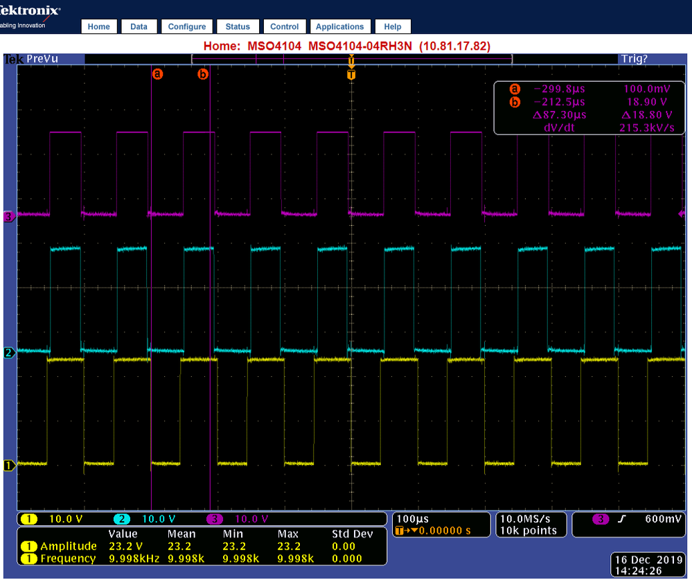

appioninc
Adding the Scope plot of the V_DCB Voltage Divider output spike once the system tries to drive the motor....

Hello to narrow down the variables I have replaced the 8MHz MEMs oscillator with a 10MHz Oscillator and measured the BUSCLK, OSCERCLK, and PWM_FREQ all of which match the clocks measured with the FRDM KV11 setup.
Everything is functional but I am getting a massive voltage swings(positive and negative(below GND) on the outputs of V_DCB and I_DCB measuring circuits when I go to run the motor.  All the parameters in the MCAT/PMSM Freemaster tool are the same as when I run the motor with the FRDM KV11 board.  I recently went to try and see if I could just get the motor to spin using the Parameters Measurement tab and I ended up frying another PCB/n-FET combo.

I have measured the FRDM_KV11 BusClock and the BusClock on my custom PCB and they are the same 25MHz.
I also see the same PWM Frequency at 10KHz.
