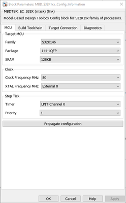

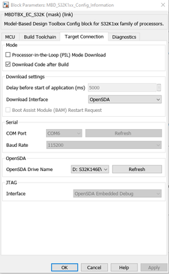

I'm working with a S32K146EVB-Q144 board, programmed from Simulink version 2022b.
I'm capable of flashing it with very basic codes, but so far I haven't been able to run it in external mode, and I can't find documentation on how to do that.
Question 1: Is it possible to do it from my version of simulink?

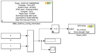

Question 2: If it is possible, then what am I suppose to change in the code (I can't attache code to this message, so check following screenshots - its very basic)
arpsa_0-1733851487371.pngarpsa_0-1733851487371.pngarpsa_1-1733851514471.pngarpsa_1-1733851514471.png

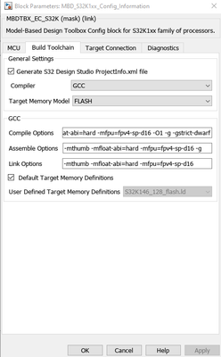

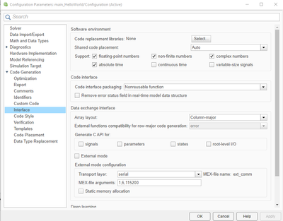

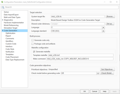

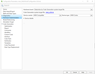

And the following configuration:
arpsa_4-1733851592272.pngarpsa_4-1733851592272.pngarpsa_5-1733851613337.pngarpsa_5-1733851613337.png
Note that on this last figure, if I check "External mode" then nothing works anymore. I can't even flash it.
Question 3: Once parametrised correctly, what is the procedure to enable the external mode? Use the SIL/PIL app, or the embedded coder app of simulink?
Objective: Change the values in the constant blocks "a" or "b" and get their sum on the dispay block while seeing the LED turning on when this sum is <3.
