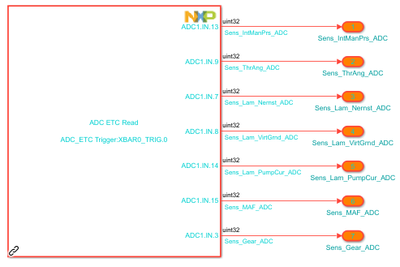

I'm working with the imxrt1062 and trying to measure 7x pins on ADC1 and 6x pins on ADC2 using ADC_ETC.  The application is built from the MBDT/SDK Example for ADC_ETC.
It can be replicated on the EVK.
When previously tested, ADC_Polling, rather then ADC_ETC delivered the expected results.

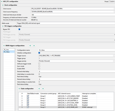

My issue is that several pins measure only noise, ADC2.IN.1 and ADC2.IN.2.
I can measure at the pins using a multimeter and they're a stable 3.3V. I can measure the "incorrect pins" with a neighbouring ADC (eg. Fuel_Level) and the values are correct. I can flash the code to the EVKB_1062 and see the same issue on the same channels so I'm sure that the issue isn't in the hardware.

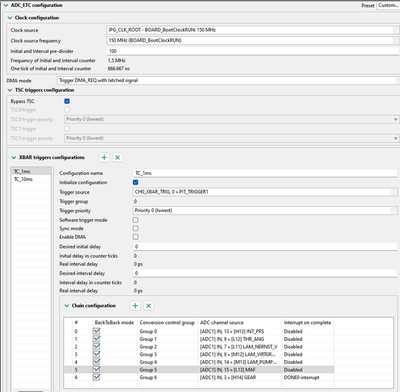

My setup with the best results are:
ADC1:
ADC2:
ADC_ETC:
I see no improvement or no measurements at all if I:
- ADC2: Set Trigger source to CH1_XBAR_TRG0 (Trigger Group 4)
- Remove "Bypass TSC"
- Change my PIT_Timer (1ms, 10ms, 100ms)
- Remove Back2Back and set delays and intervals
- Set ADC1_Channels as all Group 0 and ADC2_Channels as Group 1
- Change priorities
- Set up sync mode with ADC1 and Trigger Group 0 and ADC2 as Trigger Group 4

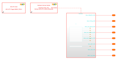

Here's the setup in Simulink to measure:
What am I missing? How can the issue be fixed to measure correctly all ADC1 and ADC2 channels.
