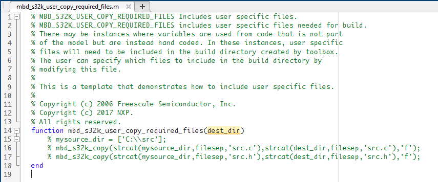

hello folks,
i am using s32k144 and using mbd toolbox from NXP to generate code in Simulink. while there are some low-level driver and also later the CCP driver written in C need to be use/integrate into the model.
I followed the Legacy-code-tool instruction from Mathworks and generated related s function and also tlc.
now, if I manually copy my customer.c and customer.h into the target folder xxx_ mbd_rtw during the code generating process, there is no error, while it could not be done automatically.
please kindly give me a direction for how to manually copy/add customer files into during the code generation process?

I could not find the 'mbd_s32_user_copy_required_files' in my s32k toolbox installation folder.... while, I found a similar script in C:\MCToolbox\rappid564xl\rappid564xl\mscripts which is for the chip MPC5643L.... and it requires rp_copy function which is located in the same folder.
it works when I modify it to fit my setup. so I think my problem solved...
having said that, is there any documents about the rp_copy, or mbd_s32_copy(in mbd_s32_user_required_files) which can help me understand what is the different between those xx_copys and the matlab copyfile function?
thank you.

Hello @bolei,
MBDT for S32K1 provides a callback for such cases when you want to copy some additional files next to the generated code and to cross-compile them together.
You can access the user copy required files script by typing the below command and editing the m-file using the template provided into the script.
edit mbd_s32k_user_copy_required_files
You can identify the name of the model because typically the dest_dir ends with the /<model_name>_ert_rtw
