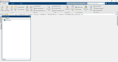

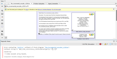

while installing MBD tool box S32K1xx, this error is showing at the last step::  index  exceeds array bounds

i have license file in lic folder. still this issue is showing

Thanks for letting us know about the problem. I will take a look to see what's going on.
Meanwhile, the toolbox can also be manually activated. All you have to do is to copy the license inside the lic folder.
IMPORTANT! Make sure the license file is named exactly 'license.dat'
Let me know if this solves your problem.
