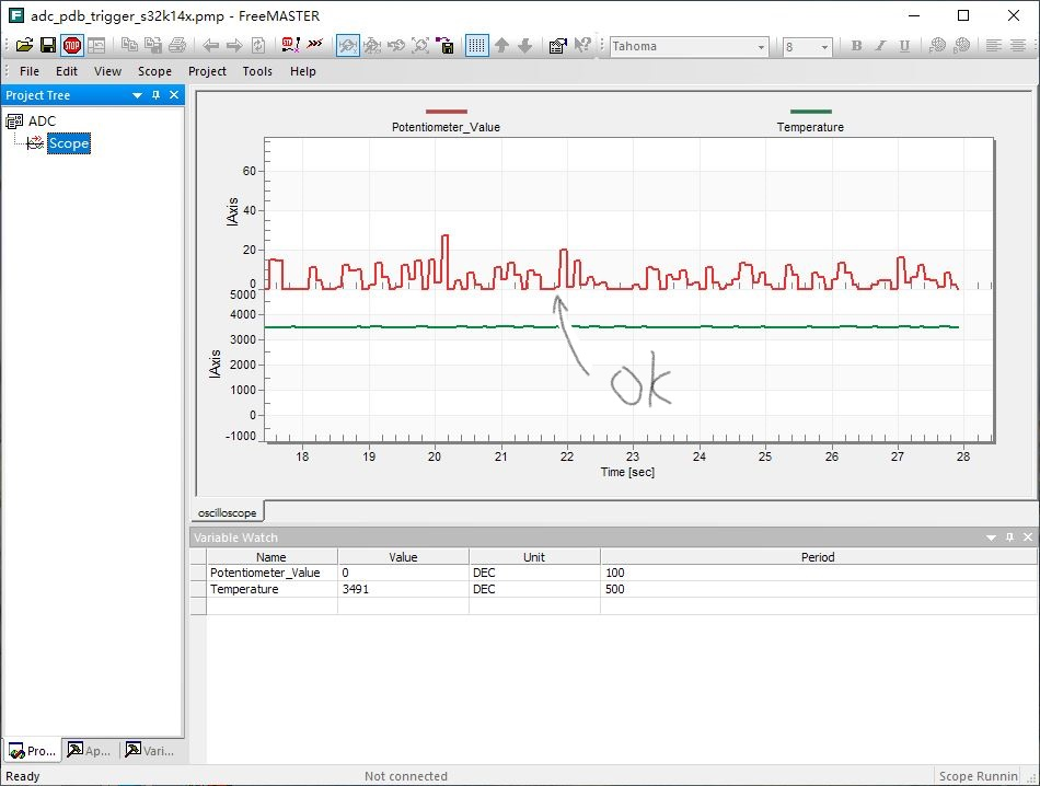

    But runing the following sample model on the same control board:“adc_isr_s32k14x.mdl","adc_software_trigger_s32k14x.mdl","adc_pdb_trigger_s32k14x.mdl"(changed the corresponding port),Can normally obtain ADC conversion results.

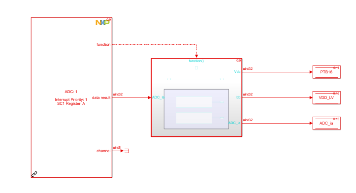

First of all, inside your config block the "Download code after build" option was unchecked, so probably the board was not even flashed with the generated and compiled code.
Secondly, after I flashed the board, the FreeMaster ("borrowed" from our ftm_pdb_adc_chaining_s32k14x.mdl examples) the ERRCH0 was 1, which means, according to the RM that a conversion is started when another conversion is in progress.
What I did, was to change the SC1 Register from B to A. Now it works. Probably it needs to start with the first SCI register and complete them in order starting from A...

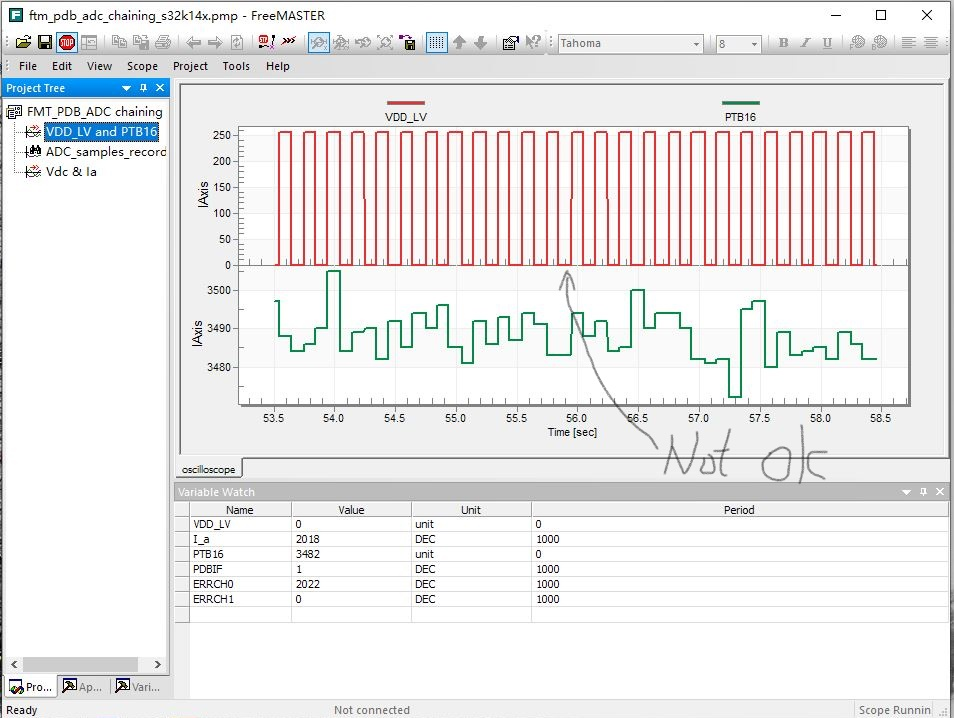

    Since the actual application needs to use multiple ADC channels, now we want to add ADC_ISR module to the model to synchronize the operation of each ADC channel, but what we get is an error, as shown in the figure below, The conversion result is like a square wave signal.
        The correct conversion result is shown below, which is obtained using a single channel ADC.
        Is this because ADC_ISR cannot be used this way or is the model misset?

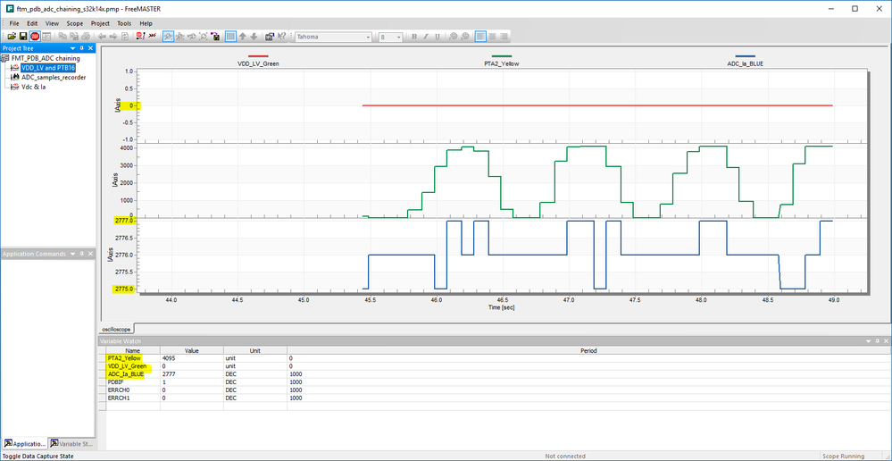

Well, the project attached is working as expected. and no errors got on ERRCH0 or ERRCH1.
What you did, to include the interrupt inside another interrupt S-function is not quite correct, but when the toolbox generates code, it knows where to declare the interrupt handlers.
So what I did, was to connect the PTA2(ADC1_SE0) at GND, as you can see constant 0. (RED)
I connected the PTD4(ADC1_SE6) to the EVB potentiometer si the value was alternating from0 to 4095 as expected.
For the last one. the PTB_12 I connected it to the 3V3 constant and the value was slightly moving from 2775 to 2777, perfect conversion.
Marius

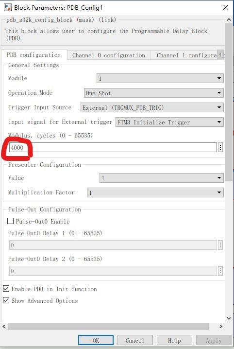

    Sorry more questions.Because the actual application of PWM output frequency needs to be set as 20K Hz, which causes a new problem.My Settings are as follows:
    It was found that ADC could not work normally, and the sampling time was changed from 0.1 to 0.001. ADC module still could not start, as if ADC had only worked once, and the sampling result was incorrect.
     In this case, how to adjust the timing of each module?

    According to the document you provided, the sampling cycle of ADC should be set as two PWM cycles. Then, I modified my test model by referring to the PMSM control example model, but the result still failed to start ADC. Is there any other cause

Probably the timing is not right. So in order to help, please have a look on our PMSM_ClosedLoop_s32k144 model example. The PWM performs at 20kHz as well but the ADC are converted at every 2 crossing zero of PWM, so not every time.
