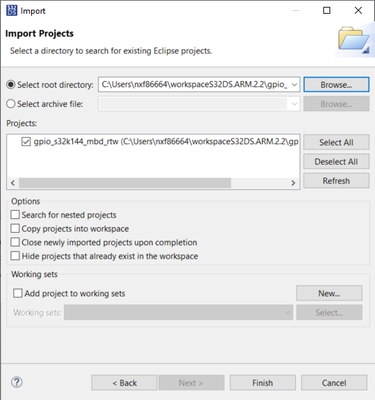

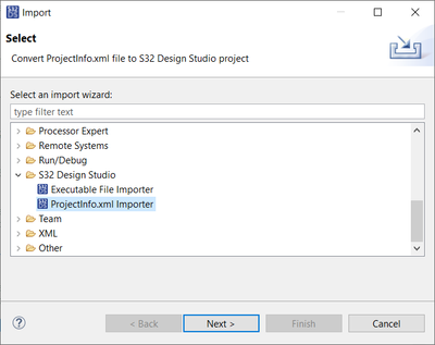

  • Open the S32 Design Studio IDE for Arm® 2.2 and import the ProjectInfo.xml:
  • Open the location where the generated files from Matlab are located, my location is C:\MathWorks\Toolboxes\NXP_MBDToolbox_S32K1xx\S32_Examples\s32k14x\gpio\gpio_s32k144_mbd_rtwstefanvlad_2-1715328806603.png
  • Build the project with the S32 Design Studio IDE for Arm® 2.2

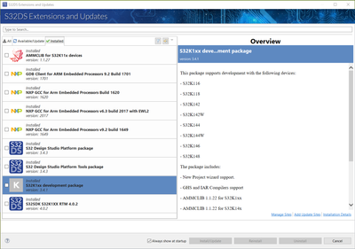

Download and install the S32 Design Studio v3.4 S32K1 Service Pack 1 released! - NXP Community

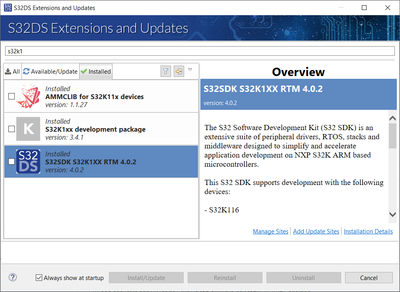

To add S32K1 support, open the S32DS Extension and Updates and check if the S32K1XXX packages are installed:
Then open Matlab r2021a and the GPIO model gpio_s32k144.mdl, then press Ctrl+to build and flash on the board:

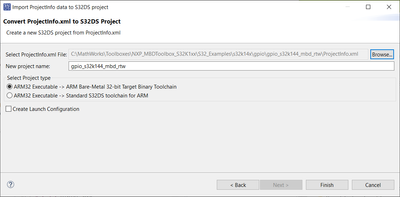

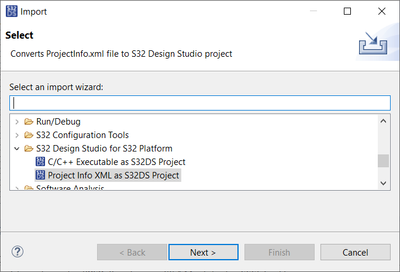

After this open the S32 Design Studio for S32 Platform and Import Info XML as S32DS Project:
Then select the ProjectInfo.xml file from C:\MathWorks\Toolboxes\NXP_MBDToolbox_S32K1xx\S32_Examples\s32k14x\gpio\gpio_s32k144_mbd_rtw:

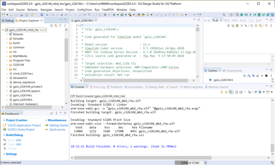

Then open project settings in S32DS for S32 Platform and go to C/C++ Build -> Settings -> Tool Settings -> Standard S32DS C Linker -> Libraries:
And add ":" on each entry, this will be modified to ":S32K14x_AMMCLIB.a" and ":libm.a".
