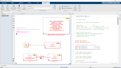

I am implementing MBDT through the example file attached below.
I checked that the S32 Design Studio for ARM Version 2.2 program works normally for the same file.
However, I don't know if the S32 Design Studio for S32 Platform 3.4 program doesn't work as below.
S32 Design Studio for ARM Version 2.2  creates libm.a file and builds well.
However, libm.a file is not generated in program S32 Design Studio for S32 Platform 3.4

  • Open Matlab r2021a and the GPIO model gpio_s32k144.mdl, then press Ctrl+to build and flash on the board:

Then open Matlab r2021a and the GPIO model gpio_s32k144.mdl, then press Ctrl+to build and flash on the board:

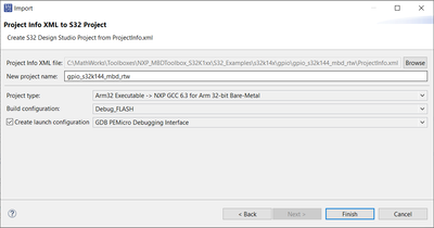

After this open the S32 Design Studio for S32 Platform and Import Info XML as S32DS Project:
Then select the ProjectInfo.xml file from C:\MathWorks\Toolboxes\NXP_MBDToolbox_S32K1xx\S32_Examples\s32k14x\gpio\gpio_s32k144_mbd_rtw:
Then open project settings in S32DS for S32 Platform and go to C/C++ Build -> Settings -> Tool Settings -> Standard S32DS C Linker -> Libraries:
And add ":" on each entry, this will be modified to ":S32K14x_AMMCLIB.a" and ":libm.a".
  • Open the S32 Design Studio IDE for Arm® 2.2 and import the ProjectInfo.xml:
  • Open the location where the generated files from Matlab are located, my location is C:\MathWorks\Toolboxes\NXP_MBDToolbox_S32K1xx\S32_Examples\s32k14x\gpio\gpio_s32k144_mbd_rtwstefanvlad_2-1715328806603.png
  • Build the project with the S32 Design Studio IDE for Arm® 2.2

1,942 次查看
autics
@stefanvlad
I'm sorry for the late reply.
I also succeeded in the way you described it.
Thank you so much.
