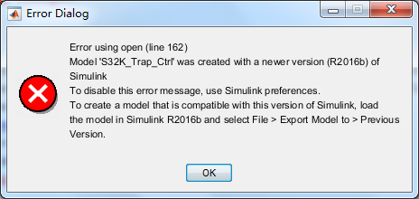

jack_zmh
Thanks,Daniel. I'm sorry I can't open your file by Matlab 2015b.Could you please export it to lower version?
1,531 Views
dumitru-daniel_
Hi Jack,
Please find the Simulink model attached for Matlab 2015b as requested.
1,530 Views
jack_zmh
Thank you very much,Daniel. I can open the file now.
