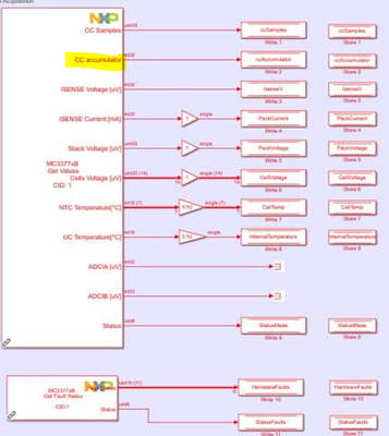

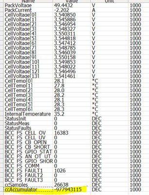

We are using MBD toolboxes for our BMS studies. We calculate SOC with an observer but we also want to see Ah counting on BMS IC. When we look at the MC3377xB_Get_Values box outputs it said CC_Accumulator, what it the unit of this output? Is it summation of mAs of all CC Samples or any other math behind it? When we draw 2A, we are observing 977943115 for this output like image below.
Thanks.

On MC33771C's data sheet there is a passage is showing actually ccAccumulator ( not in MC33771B data sheet by the way) , but it didn't explain what is the logic in there also. Am I getting summation of all samples in 1 time step or not, if so , when we tried, it gives way much higher results.(We checked with constant current)
For ex : ~2000mA constant current and nSamples are ~1300, accumulator should give ~2.6M but it gives ~46M.

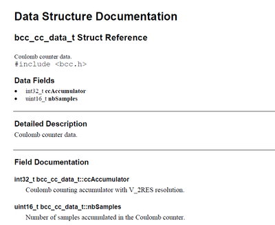

What I understand on how CC accumulator works is that every time you start a conversion the nbSamples are incremented and to the ccAcumulator is added the converted value for the ADC2 which is the current measurement. Now, both of the blocks (either if we talk about raw or measurements are reporting this in raw values). So the value that you see on the accumulator is raw data value and not converted in mA. This is why the output for the ccAccumulator is int32. You are expecting this to be in mA but it is in raw.

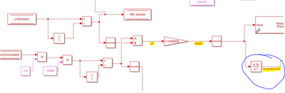

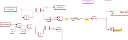

Thanks for the zip file. We changed it but still we are observing wrong values. Here you can see our model ( we just add calculations which calculates uA from raw data like in the datasheet).
By the way, when we look at the datasheet, units seem to us strange at this passage. Shouldn't it be A rather than uA according to ohms law.

This is a typo that will be corrected in the next release of the datasheet (planned for 1Q21). You should read A instead of µA.

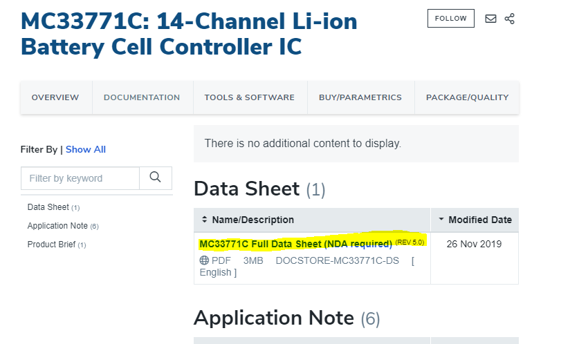

@bcelikte, I noted that you said in your previous post that "I download the both full data sheet. MC33771B's data sheet is dated Feb.2019 and MC3771C's is Dec.2020 and it is more detailed".
Note that the latest revision of the datasheet for MC33771B is rev6.0 dated 15 July 2020 and not Feb 2019. The latest revision of MC33771C datasheet is rev5.0 from 21 Nov 2019. You should be able to get them from DocStore.
