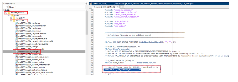

TPL communication as monitored by the S32K144 appears to be blocking. So, if TPL communication fails for some reason code execution on the S32K144 is stopped until a time threshold is crossed. Is there a way to change the duration of that time threshold?
545 Views
SorinIBancila
Hello @ranulf,
In the MC33772B configuration block's tlc you can find the following define: #define BCC_COM_TIMEOUT_MS 10.
You can try to modify this value to increase/decrease the timeout.
