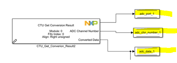

I have one general question for the community:  When using the blocks within the MBDT for the 5744P called 'CTU Get Conversion Result'.  If you have more than one ADC sample you are trying to retrieve from the ADC, how do you know which sample will come out of each block when using these blocks?  The attached model uses synchronous ADC sampling on both ADC0/ADC1 and I would like to understand using these blocks how I can anticipate which block will house which ADC sample.  Is there a way to determine?

For the second question, the results are stacked in a queue. For each result you want to get from the queue, you have to use the CTU Get Conversion Result block. Now, in order to know which ADC provided the converted value, You have to consider the outputs: the first one gives you the ADC instance, the second gives the channel number while the last one provides the value.
For example if the ADCport = 0 and ch_number = 5 then the converted result comes from the ADC0, Channel 5.
