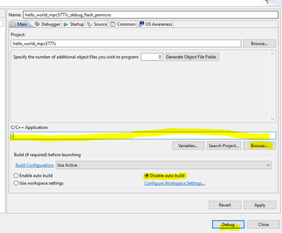

Until then, you can bypass the Bootloader flashing method by using the S32DS. Basically, you have to m manually flash the Simulink generated code using the S32DS.
The easiest way to do that is to import an example for the MPC5777C, let's say Hello World. (Go to File -> New -> S32DS Project from Example)
Then go to debug, select the new created project, go to Browse and select the generated .elf by the SImulink project. Disable the autobuild and press Debug.
Now the code should be deployed on the board and the code should run.

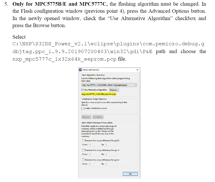

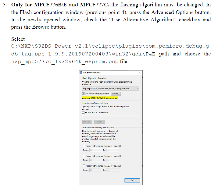

It turns out there are additional instructions in the Quick Start Guide document that is part of the NXP MBDT installation:
C:/Users/T5810/Documents/BanP/EV-models/NXP-MBD/Model_Based_Design_Toolbox_MPC57xx_Series_Quick_Start_Guide.pdf
The additional instructions "only for MPC5775B/E and MPC5777C" indicate the flashing algorithm must be changed, by selecting the PCP file "nxp_mpc5777c_1x32x64k_eeprom.pcp" from the PEMicro Eclipse plugin files, see attached.
Specifying the alternative flashing algorithm does appear to resolve the errors flashing the bootloader to the MCU.

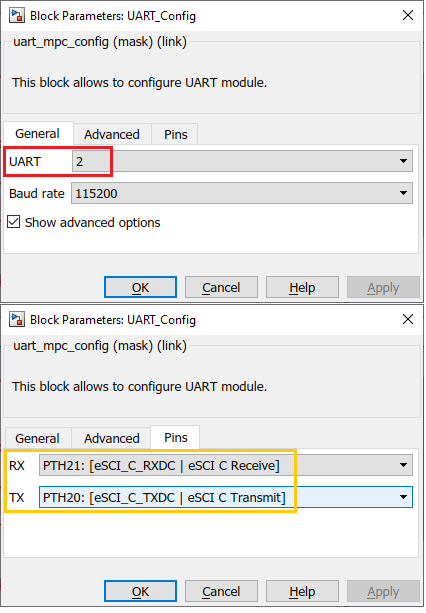

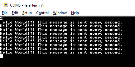

Trying to connect TeraTerm to COM3 (the USB serial port assigned to the board and used by Matlab/Simulink to download the model build to the board) that I did not see the "Hello World!!!" messages. Trying various changes to work around the problem, I discovered that if we change the UART instance from 1 to 2, the "Pins" tab of the "UART Config" block a new and different set of pin selections for RX and TX that were not available for (default) UART instance 1, see below.
Making this change allowed the serial output stream to reach TeraTerm using the same port COM3 that was silent when (default) UART instance 1 was tried.
How does the "UART Module" (UART index selection) affect our design?
Why does UART index 1 not work, even with Matlab/Simulink closed?
It would be great to better understand how this works.
I suggest changing the "Hello World" example "UART Module" (UART index) selection from 1 to 2 in a future release of the toolbox, or mention it in the Quick Start Guide, since it seems to be required for the example to work (seeing serial output).

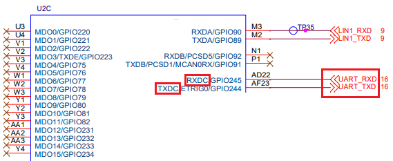

The reference design schematic shows why UART Module 2 has to be selected:
RDVCU5775EVM reference design – Schematic
In the schematic (see below) it shows that only RXDC and TXDC on the Microcontroller connect to the UART, the last letter "C" in the name of those pins corresponds with UART Module 2.  When UART 2 is selected in the MBDT "UART Config" block, pins [eSCI_C_RXDC] and [eSCI_C_TXDC] become available in the "Pins" property page; those correspond to the pins connected to the UART on the schematic.
A future version of the Quick Start Guide for RDVCU5775EVM deserves to be updated to mention this setting.
