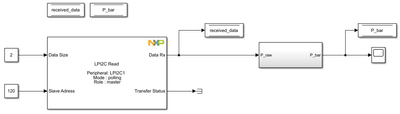

Hello everyone,
i want to use the i.MX RT 1170 EVK as a target platform to test and develop control devices. Therefore it is really important to have a fast logging of the measured signals. In the picture below you can see the current model with which I am currently doing tests. 
I read the I2C data and then do some calculation to convert the data into a physical unit.
I am using the following model settings:
Solver: FixedStepDiscrete
Fixed-step size = 0.001
After I have set the External Mode, I used the "Monitor & Tune" to download the model onto the target and connect Matlab to it. All works fine, but when I open the scope, i see an interrupted signal (picture below). There is short time in which I can see the measured signal, but there are also some breaks, where no measured signals arrives.
In the picture below you see my setting of the External Signal & Triggering options. 
Is it possible to have high-resolution signals while using the external mode of matlab without these breaks? What do I need to change in my settings?
By the way, what is the best way for logging and storing the signals from External Model in Matlab to have them available for a later use like plotting oder evaluations? The block "To Workspace" worked not for me, i get a the following warning Saving external mode simulation output as a single object is not supported because the workspace variable 'out' is not created during model code execution.

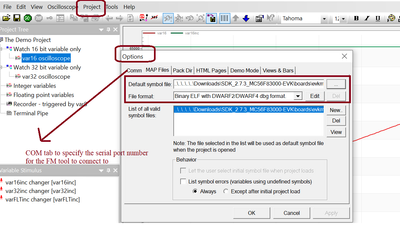

Hi @allmo ,
If you need to visualize in real time the variables/signal of your model you can use also the FreeMaster tool. I think is a better option that external mode in terms of features and connection stability.
You can find here a detailed presentation of the tool and it's capabilities.
It has nice features that allows to visualize and also modify variables in real time, record variables; it has different options to see variables/signals in a oscilloscope and also capture the data displayed in a local file; here is a post on this topic: https://community.nxp.com/t5/FreeMASTER/How-do-I-get-the-full-values-of-variables-in-FreeMASTER/m-p/...
The toolbox has special blocks for Freemaster:
To enable your model to use the freemaster, you need to add the Freemaster config block in your model and use Build, Deploy&Start application from Simulink that will build and download the application on the board. (you can also check the LPI2C examples from the toolbox that have this block added and uses the FM to see the variables send/recv via I2C).
You need to install Freemaster tool v3.1, open it and set up your project by specifying the path to the elf file you just created from simulink: (Project->Options)
I hope this helps,
Alexandra

That period set in defines the oscilloscope sampling period. You can try to sync this value with your model step size. You can try also the recorder feature of the freemaster that allows a faster sampling here is a short description on how the recorder works:
"4.1.1.3 Recorder
The Recorder item in the Project Tree structure defines a real-time recorder chart to be shown in the Detail View pane. While the Oscilloscope periodically reads variable values and plots them in real time, the Recorder runs on the target board, reads application variables, and sends them to the FreeMASTER tool in a burst mode. The recorder variables are continually sampled and stored into a circular buffer in the target board application. When the trigger event is detected by the target, data samples are counted until the number of Recorder samples is reached. At this point, data is sent to the FreeMASTER application. This mechanism enables the use of a much shorter sampling period and enables sampling and plotting of very fast actions."
I am also thinking that you can try to set up the the LPI2C to work in transfer mode - this is done from .mex file of your model, choosing transfer in Master Configuration; you can also see an example for configuration in the toolbox, in evkmimxrt1170_lpi2c_master_trans_recv.mdl(and the evkmimxrt1170_lpi2c_master_trans_recvConfig.mex file).  the function callback will be called when the data is received from the sensor device.
I also found this article on mathworks on parameters tuning on external mode, exemplified on TI: https://www.mathworks.com/help/supportpkg/texasinstrumentsc2000/ug/parameter-tuning-and-signal-loggi.... It explains also how to save the values for offline usage.
Alexandra
