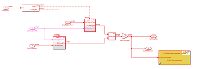

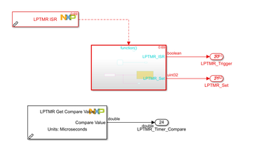

Hello @Sam_ECU ,
Indeed the LPTMR Set Compare Value is changing the internal compare register for the LPTMR. When you use this block, this will stop the LPTMR, update the Compare value and then Start the LPTMR counter again.
Now, you are right, I've tried the example out of the box, and seems to not work as in the description. But the issue here is that initially, the model has been developed in R2016a I think, and now I've tried in R2018a and the code was generated in a  different order. See below. Basically, the new compare value as updated before computing the new one.
After changing the block's priorities, on how the Simulink should generate value, the code has been generated in the right order, and the model works as expected.
The Read compare value should work the same either if you call the block inside the interrupt or not. However, if you use this block inside the interrupt it matters if the generated code reads the value before or after you call the update to compare value.

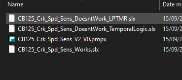

I've attached 4 files.
The Freemaster file I use with each of the three simulink models.
"CB125_Crk_Spd_Sens_Works.slx" works in Freemaster without issue.  (The LPTMR is in the model and works without issue and after being set by a constant value)
"CB125_Crk_Spd_Sens_DoesntWork_LPTMR" immediately looses connection with the board in Freemaster. (The LPTMR Set Block is updated by the calculation for the Time per Crank Tooth.)
"CB125_Crk_Spd_Sens_DoesntWork_TemporalLogic" generates correct data for some, incorrect for the others data in Freemaster.  Then after several seconds it looses connection with the board. (I've the aim to use time outs in Stateflow)

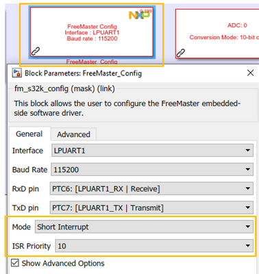

Sam_ECU
Contributor V
If anyone comes across this post, I found the solution for my model.
The issue was the setting from Freemaster.
The solution, at least for myself:

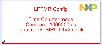

Sam_ECU
Contributor V
Hello @mariuslucianand
I've been playing further with the LPTMR for my application.  The timeout issue within Freemaster + Code not working is 100% linked to the settings of the LPTMR Config Block.
Attached you'll find two files.  The first works without issue, but the LPTMR_Clk is to slow for my application.
In the second file the initial compare value for the LPTMR is changed from 1,000,000 --> 10,000.
The application is fine until it receives the first ISR from the FTM-Module.  (For your testing you'd have to input a signal to the FTM-Module and change the activation settings for the LPTMR.)
What's the issue?

Sam_ECU
Contributor V
Hello All,
Additional Information from me in case someone is following this topic.  The LPTMR example above works, but to read the compare value it has to be in a higher level then the subsystem.  Reading the compare value within the subsystem is what led me to believe the example was working as intended.
My first question remains the same.  Is there any alternatives for my application other then LPTMR?

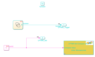

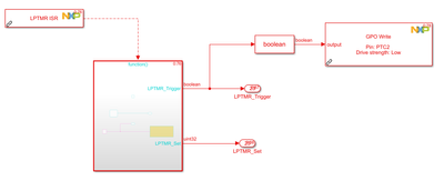

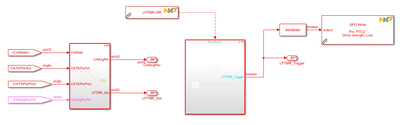

Sam_ECU
Contributor V
Hello All,
I've been trying to understand the LPTMR but just keep running into issues and would appreciate any and all help.
I've understood, that Channel 0 for the LPTMR sets the Timer within Simulink
When I set up a Stateflow with temporal logic, the application works for ~30 secs and then Freemaster appears to loose connection to the board.
If I try and use the LPTMR Channel 1 with the "Set Compare Value" block, as long as the "Set Compare Value" is defined within the ISR Function (from a constant) everything (including Freemaster) works without issue:
But as I want my timer to be set by changing external conditions, I try to input my calculated value into the ISR-Function to set the compare value, but connection to the board is lost in Freemaster.
I can output the timer to a GPIO a measure the set value with an oscilloscope and it appears that the code is working correctly.
I've tried defining the Set Compare Value outside of the LPTMR-ISR-Function.  The issue remains the same:
