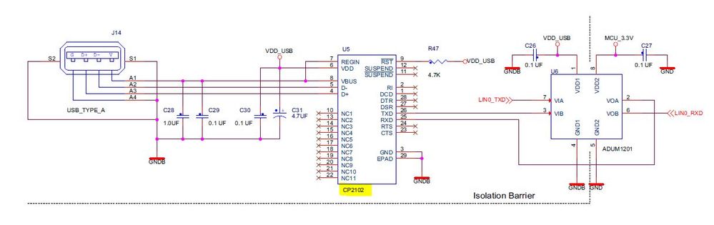

I read the quick Start Guide,the web http://www.nxp.com/assets/documents/data/en/quick-start-guide/MTRCKTDPS5643LQSG.pdf  ,and the' Software tools installation ' in the page 6 ,i did as step one by one  in discription,but when in the step 3 ,i can not find  CP210x COM port driver in Device  Manager.

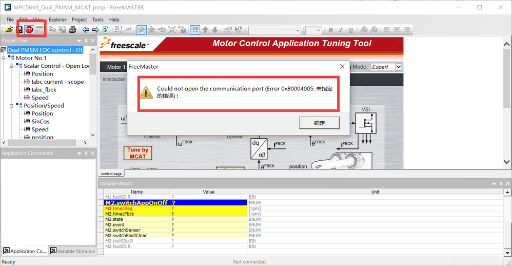

When i open the FreeMaster and Click on the Stop button,and popup the Error Windous.What is wrong with it?

The controller board has a chip that translate the USB2UART. This chip is called CP2102.
This is a chip from Silicon Labs: USBXpress USB Connectivity Bridges | Silicon Labs
In order to use it you will need to install the driver for it before being able to select it from Freemaster. This will emulate a virtual COM port in Windows that you will need to select in Freemaster.

I Now Freemaster has no problem!

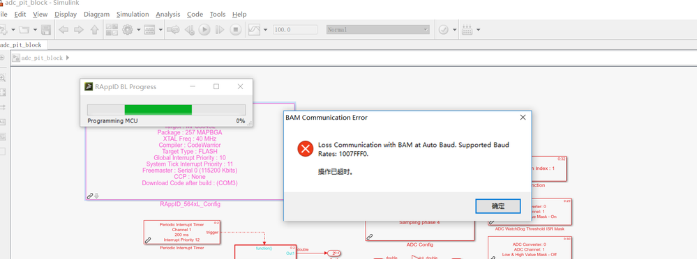

But using the simulink down load the program has error! i don't know how to do!

I think you are very close to have it working. As i suggested before - i would short the J18 to have ASB2 = 0 (no auto baud verification)
Then i would try to flash the program by changing the UART baud-rates - starting with the lower ones up to 115200kbps

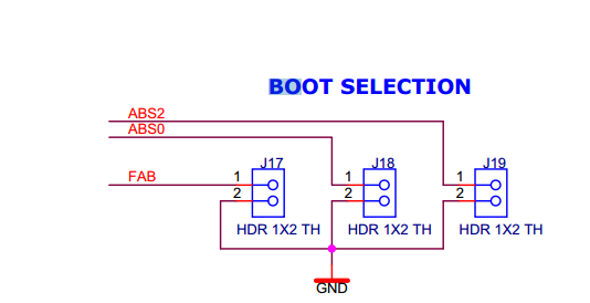

My friend! My board J18 to ABS0;J19 to ABS2;J17 to FAB.
As Picture shown:

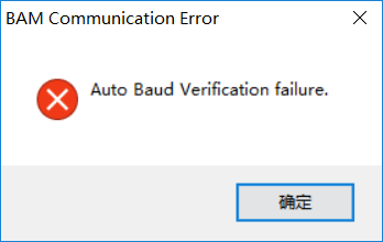

I short the J18 to have ASB0 = 0,testing that my program is not down load in board!
I short the J19 to have ASB2 = 0,testing that my program is not down load in board!
Daniel,Hey ,depressing!

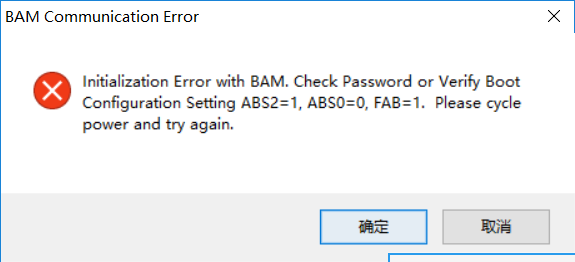

Now,there is a good news,We can down load the program in to the board using the IDE ,but the if i use the Simulink is not down load the program!
the error shown as before!
