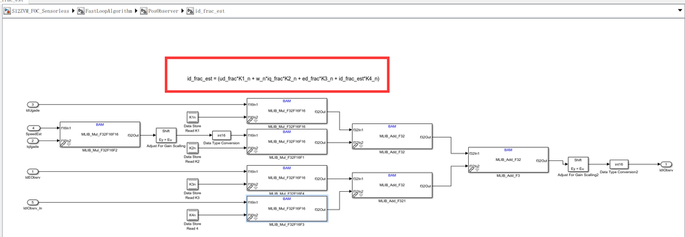

Shown as below,how to deduce the id_frac_est = (ud_frac*K1_n + w_n*iq_frac*K2_n + ed_frac*K3_n + id_frac_est*K4_n)?
I don't know how to deduce it,and the id_frac_est  is deduced form  EMF?
Original Attachment has been moved to: S12ZVM_FOC_Sensorless.slx.zip

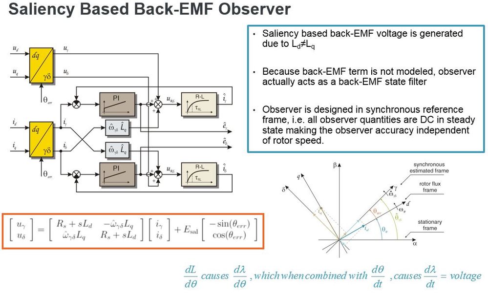

Let us start from the observer equation highlighted below. This equation is written in a synchronous reference system gamma/delta.
The Simulink model is used Id_est/Id_obs and Iq_est/Iq_obs but if you go over this inconvenient and replace with gamma/delta the d/q quantities you will reach to the conclusion that the blocks id_frac_est and iq_frac_est implements the equation in the red box above.

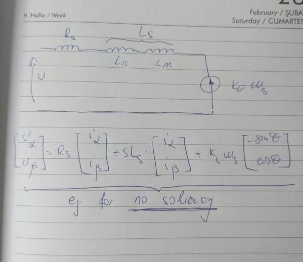

The maths behind is a bit more complex - i do not pretend to be an expert - but for an easy explanation you can start from the the non-salient motor model - where you can express as:

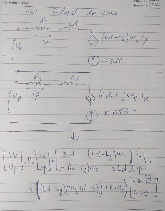

For the salient use case where Ld!=Lq the model becomes:
Now, if you take this equation and solve it in current observing frame you will end up with a similar model as the one implemented in the Simulink example.
