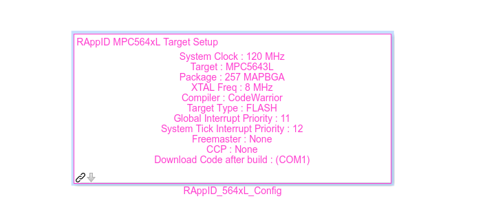

I used the the Simulink Block of MPC5643L from NXP,I wanna use it to realize the CANbus comunicatin,the External crystals is 8MHz,The target of the Baud Rate is 500K:

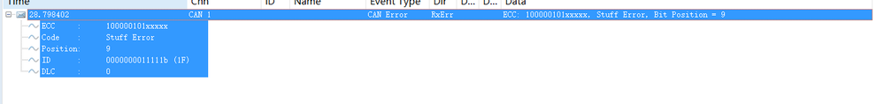

 I use the CANalyzer to display the signal,but the Error shown as below:

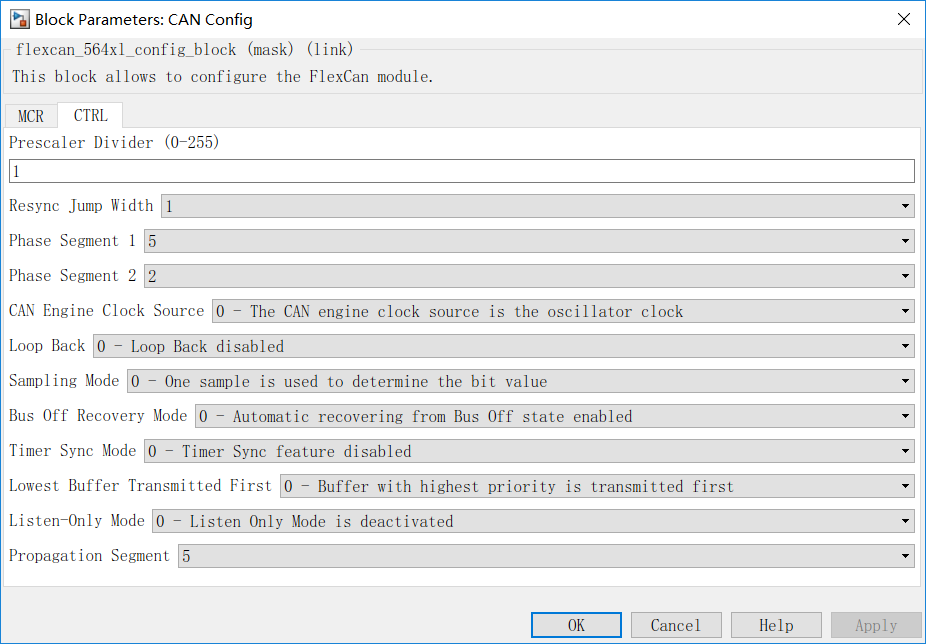

My configure about the CanBus Configure shown as below:
My calculation about the Baud rate as below:
Baud Rate=8000,000/(Prescaler*(1+(PROP_SEG+PSEG1+2)+(PSEG2+1)));
So i fill in the parameter,Prescaler=1,PROP_SEG=5,PSEG1=5,PSEG2=2,
Is there some thing wrong about the calcaulation?

Something is wrong with the formula. It's not working on my side neither. Why do you want to change the XTAL frequency ?
constantinrazvan.chivu‌,
Can you please add the formula used to compute the CAN baud-rate depending on all parameters in the Toolbox.
Thank you!

The XTAL in MPC5643L dual motor board is 8MHz,so i need to change it.But the Error i can not solve.
