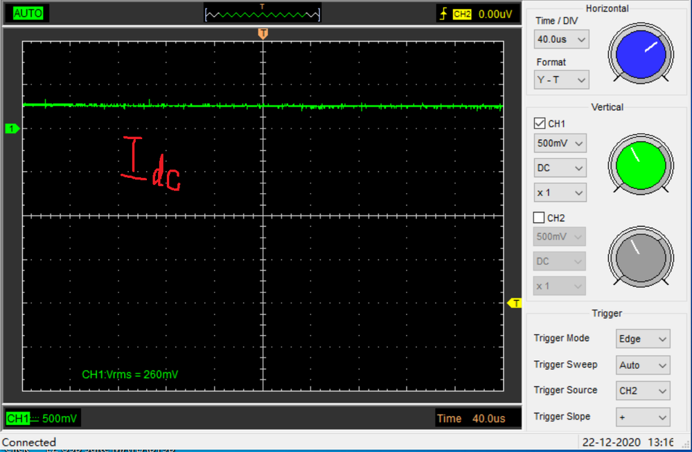

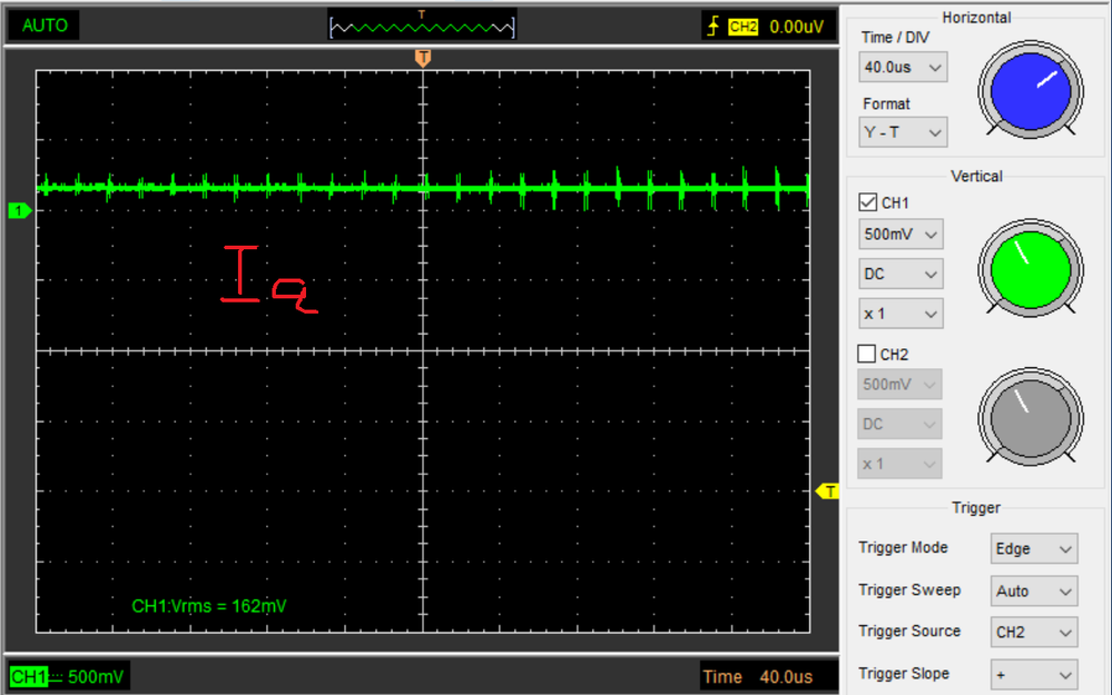

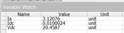

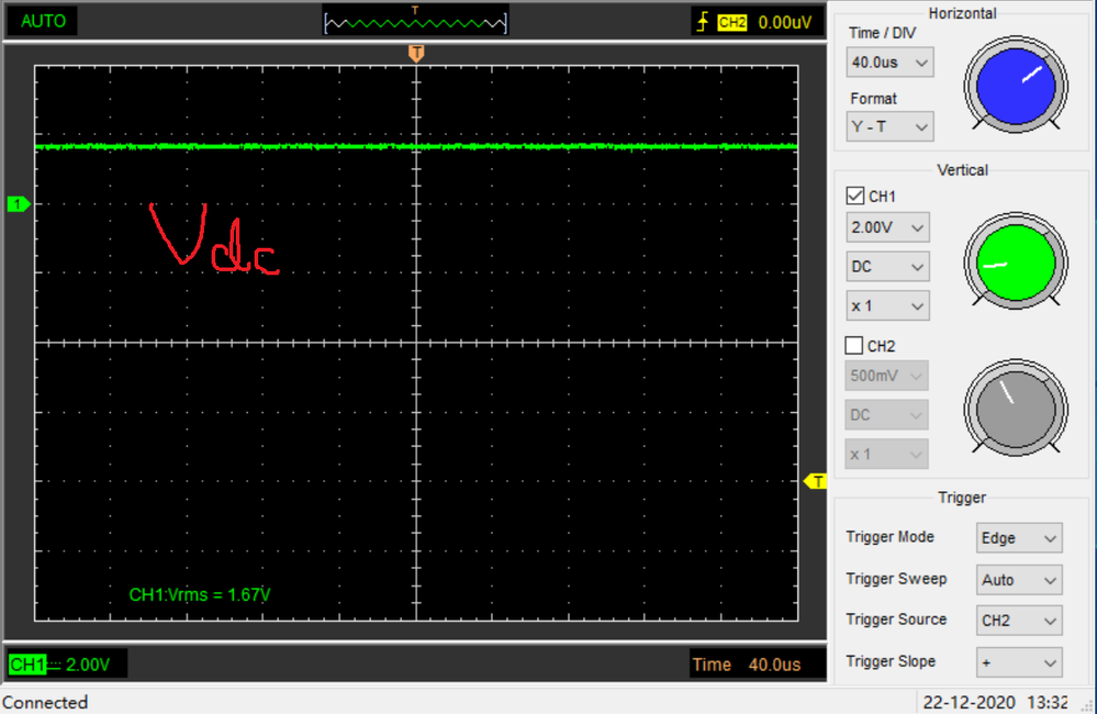

liuqimin
Hi Adrian
    PTB0 increases the interleaving to solve the problem of false height of sampled data. But now Ia, Idc sampling port still seems not to work. Use an oscilloscope to measure the actual voltage of the three sampling ports as follows. But the ADC output of Ia and Idc sampling ports is almost 0. See the variable data returned by FREEMASTER below.
Is there still a problem with the ADC module settings?
  Best Regards!
  Qimin

4,998 Views
liuqimin
Hi Adrian
    Yes, there should be no problem with the revised model. Now to solve this problem is to modify the hardware-increase the resistance of the current sampling resistor, so that after increasing the sampling voltage, the ADC can convert the data. One thing I don’t understand is that there is a sampling voltage output before increasing the resistance of the sampling resistor. Why can’t the data be converted? ADC module resolution is not enough?
    The generated BIN file is downloaded with J-LINK, so there is no OPENSDA option in the model.
  Best Regards!
  Qimin Liu
4,983 Views
adriantudor
@liuqimin ,
Hi Qimin Liu,
I think it would be great if you will share your schematic. I don't know if the ADC resolution is not enough for you because I don't know what voltage are you trying to measure. Anyway, the ADC resolution is 12 bit (that means for 5V Vref the smallest voltage that can be measured is about 1.22mV). If you measured Ia and Idc (as I have seen in your oscilloscope snapshot) and at the same time your microcontroller it was running, then you should have seen in Freemaster the corresponding ADC values.
I suggest you to create a method to be sure that every time when you flash something on your microcontroller to be sure that it has flashed (e.g.: create a dummy variable and increase it at every time step or modify your PWM duty cycle and measure it with an oscilloscope).
Adrian
