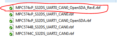

Looks like you have there an MPC5744P rev E. This board have a different Serial instance routed to the onboard USB2Serial.
To be able to download the code directly from Simulink on your board, you have to flash another bootloader, the MPC574xP_S32DS_UART0_CAN0_OpenSDA_RevE.rbf
Can you please give this a try?
Marius

ZJoe
Thanks very much, I've found the MPC574xP_S32DS_UART0_CAN0_OpenSDA_RevE.rbf
But it automatically use the other bootloader, which you can see in the attachment.
Could you tell me how to load the MPC574xP_S32DS_UART0_CAN0_OpenSDA_RevE.rbf?

Hello @ZJoe ,
The bootloader image has be flashed before using the RappId BL tool using the S32Design Studio for Power Architecture.
Please check the chapter 2.3 from this document here https://www.nxp.com/docs/en/quick-reference-guide/MBDT-MPC57xx_QSG.pdf

ZJoe
I’ve done it, thanks for your patient help.
