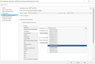

1. The CAN examples delivered with the MBDT for S32K3 are set to target an S32K344-Q257 processor, while the MR-CANHUBK344 is based on S32K344-Q172. Are your model, and its associated .mex file, that you have updated with CAN4 and CAN5 configurations, set for S32K344-Q172? If not, for a correct application behavior, I would recommend you to configure your Simulink model for the S32K344-Q172 Hardware Part, by opening the Model Settings, going to Target Hardware Resources -> Hardware -> Hardware Part dropdown, as illustrated below. After doing this please make sure you press the Apply button.
Also, please note that this process will replace the configuration associated to your model with the default one we provide for S32K344-Q172 processor. So, please consider backing up the .mex file that you have already modified before this process. After that, you could enable the CAN4 and CAN5 instances inside the new configuration, targeting S32K344-Q172, by pressing the Configure button of any of the MBDT blocks.
