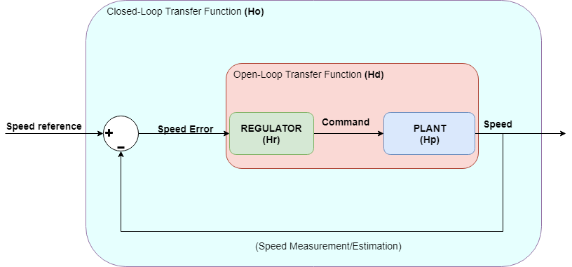

As it can be found in the Motor Control Class: Lecture 11 - Closed Loop Control‌, there are certain ways to obtain a Regulator that fulfills the purpose of the application using manual tuning. The advantage of these methods relies in the fact that you do not need an accurate estimation of the motor's mathematical model to have a satisfactory response. The downside is that you will obtain very good results only in certain cases and with a lot of Trial and Error work.We will describe analytical methods to determine the transfer function of the Regulator.
First of all, the closed loop system can be described by the following feedback control scheme:
Pole placement method, although it is vastly found as a state-space method, works great with the transfer function approach. Although this strategy may sound complex, it is one of the most natural implementation of a control algorithm.
We build the ideal transfer function (that determines the response we want to obtain) and, using the model of our Plant, we can rapidly determine the transfer function of the Regulator.
For instance, if we want to obtain the following Closed Loop transfer function (or, more adequately, the response of the following transfer function):pastedImage_13.png
We can easily determine the Open Loop transfer function:
Finally, knowing the model of our plant - Hp, we can determine the transfer function of the regulator:

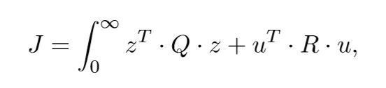

To compute the ideal regulator, we need to minimize the following cost function:
where z is the new state vector (built using the initial state vector x and Epsilon), Q is a matrix that penalizes each component of the state vector, e.g. if we do not want the motor to reach high speeds, the first element found in the Q matrix will be very big. When the speed reaches high levels, the value of the cost function will be greatly increased and, considering the fact that we want to minimize the cost function, this instance will be ignored due to its poor performances.

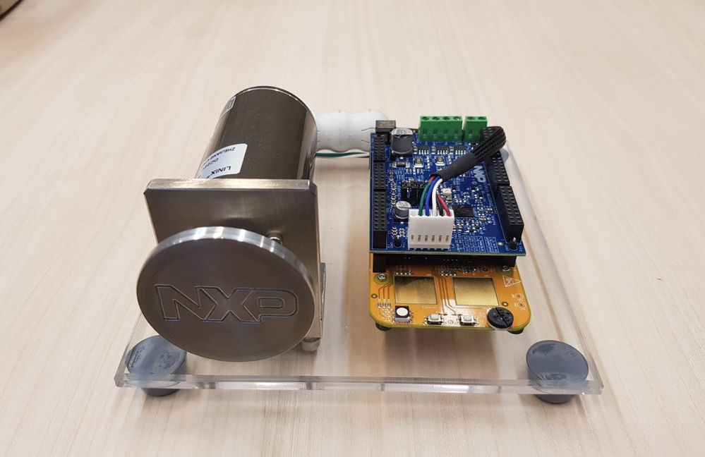

This project is built using the MTRDEVKSBNK144 development kit that includes a BLDC Motor. The setup is made using the instructions provided in the development kit page and in the Motor Control Class: Lecture 12 - Motor Control System‌ course. No further improvements added.

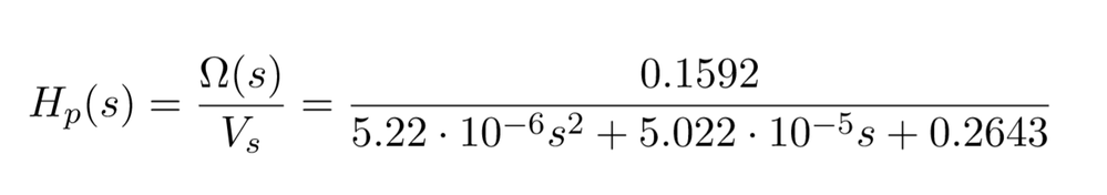

Transfer Function Model
Hp is the transfer function of the Plant, i.e. the motor itself. The two poles of the systems are complex conjugated poles:
p1 = - 4.8103 + 396.48i
p2 = - 4.8103 - 396.48i
These two poles are placed on the left side of the complex plane, both showing negative Real Part:
Re(p1) = Re(p2) = - 4.8103 < 0
Consequently, the Plant of our system is stable.

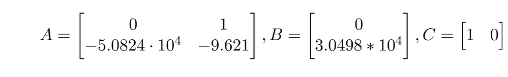

State-Space Model

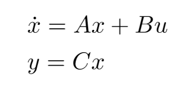

The state-space model is comprised by 3 matrices which completely describe the following equations:
where x is the state space vector, taking the form of x = [ w   ; (dw)/(dt) ], where w is the angular velocity of the motor,
y = w, and u is the input, i.e. the current that flows through the motor.
The numerical values of these matrices can be found below:
The eigenvalues of the matrix A are both found in the left side of the complex plane, so the stability of our Plant is once again demonstrated.

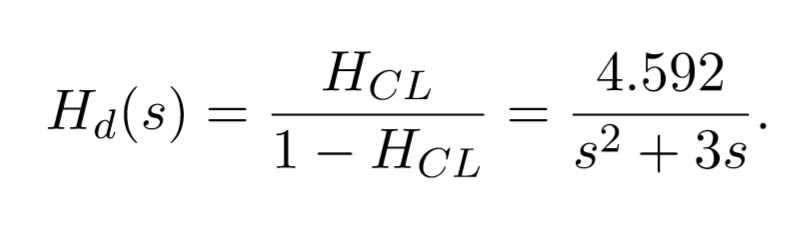

Discrete Regulator - Second-Order Closed Loop Response - Transfer Function Approach

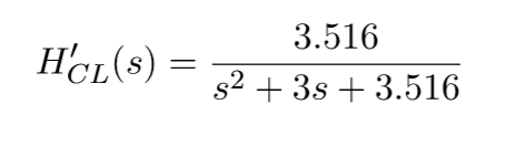

We want to obtain a second-order response considering the following arguments:
  • we allow a small overshoot (less than 5%, but bigger than 0%)
  • we significantly improve the settling time
We build the ideal response's transfer function, considering the general formula of a second-order system:
Based on the above expression, the performance parameters can be described using the following form:
Using the imposed characteristics that can be found in the Requirements Section, we can determine the ideal closed loop transfer function:
The stability of the above system can be proved using the Hurwitz criterion.

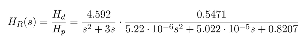

Considering that our Regulator's transfer function is determined by the fraction
we can determine the transfer function of our controller:
As it can be seen from the above expression, our regulator cannot be implemented using the traditional PID Controller. Using the same sampling time provided in the Motor Control Class: Lecture 12 - Motor Control System‌, we obtain the Discrete Transfer Function using the Trapezoidal Method:
The simulation results can be found below:pastedImage_46.png
As it can be seen, the closed loop system satisfies our needs.

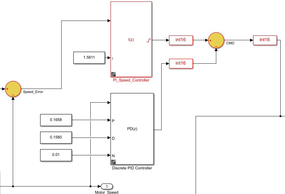

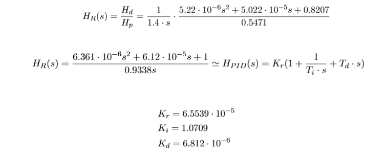

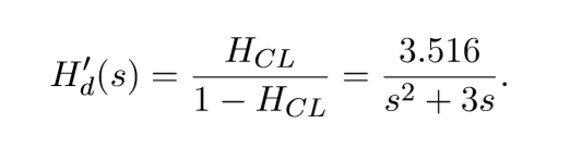

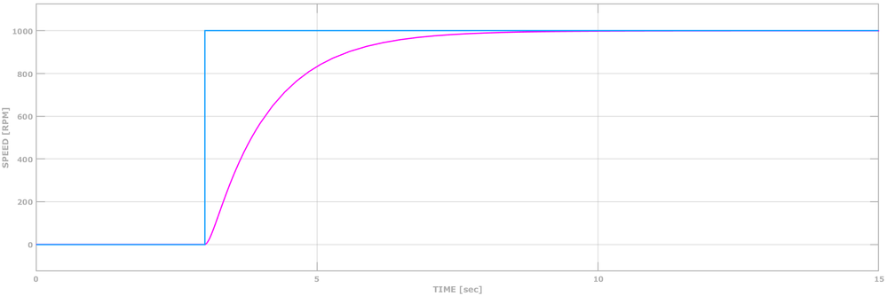

PID Regulator - First-Order Closed Loop Response - Transfer Function Approach
This approach is very similar to the first approach. Instead of following the principle of reducing the settling time at the cost of the presence of a small overshoot, this method provides a slower response in the absence of the overshoot that can cause problems near the limit regime (high RPM functioning regime).
  • we wish to obtain a response that does not show overshoot
  • the system will have a slower response
Starting from the ideal closed loop transfer function that resembles a first-order system's response:
To ensure null steady state error, we get to the following condition:
To obtain a satisfactory settling time, we get to the following results:
pastedImage_91.pngwhere tt is the value of the settling time.  Considering that we wish to obtain:
we come up with:
We can demonstrate the stability of our closed-loop system in a very natural way. This system has a real negative pole, so all the poles are placed in the left side of the complex plane, thus showing the stability of our final system.
To compute the transfer function of the regulator, we calculate the open-loop transfer function:
Finally, we obtain the transfer function of the regulator that can be implemented using a PID Controller:
Below you can find the simulation results:

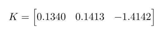

LQI Controller - State-Space Approach
As mentioned before, the final system is determined by:
The command that our regulator should generate is:
The optimal gain matrix K that solves our problem can be found by minimizing our cost function :
Our choice related to Q and R shows two important points in this approach:
  1. We want to prioritize the speed of the response, i.e. small settling time => As it can be seen, the Q matrix punishes a lot big deviations from the ideal state. If the error is too big, the value of our cost function will be big thanks to the big number in the last row, so the system will indeed perform poorly.
  2. To satisfy safety conditions, we cannot generate a command indefinitely big. An enormous command will surely provide a very short settling time, but it will harm the internal structure of the motor. This being said, we need to also punish big commands to ensure the proper functioning of the motor, hence the value for the R that is certainly bigger that the first 2 elements found on the diagonal of the Q matrix.
By choosing the right values for these matrices we can obtain the desired result.
The analytical solution of this problem can be determined by solving a Riccati equation that gives us the formula of K:
A commonly used MATLAB function can be used to rapidly generate the optimal controller:
                                                https://www.mathworks.com/help/control/ref/lqi.html
Using the above MATLAB tool, we determine the gains for our LQI Controller:
The stability of our closed-loop system can be demonstrated by calculating the eigenvalues of the system matrix:
As it can be seen, all eigenvalues are in the left side of the complex plane, so the system is stable.

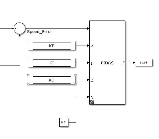

Thanks to the S32K144EVB, we can rapidly implement our controller using the Simulink Environment. We take the original project built in the Motor Control Class: Lecture 12 - Motor Control System‌ and we modify only the Regulator Block accordingly.

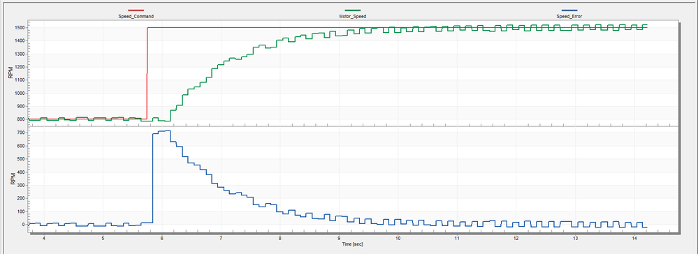

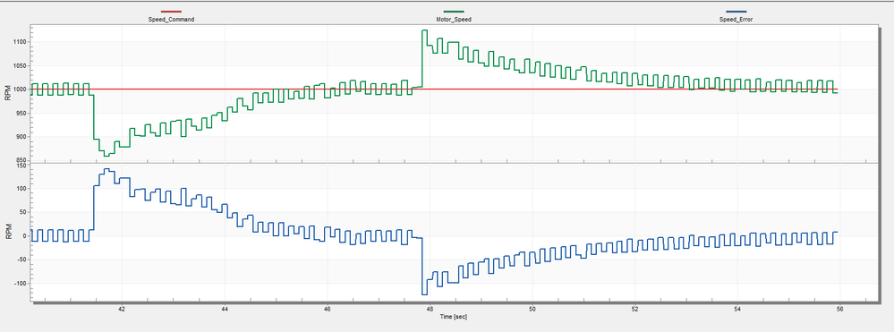

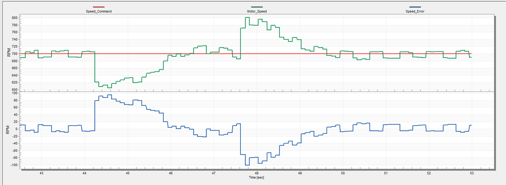

First of all, to evaluate the results of this project, we need to build a starting point. Motor Control Class: Lecture 12 - Motor Control System‌ included a Simulink project that implemented a PI Controller with Kp = 0.2 and Ki = 0.7. The results can be seen in the following images:
Default Regulator
   As it can be determined using the above images, the performances provided by the default regulator are not satisfactory. The settling time is relatively long and the disturbances are rejected very slowly. Overall, the system does not perform as it is intended.
Performance IndexObserved Value
Settling Time
7.3 seconds
Disturbance Rejection
6.5 seconds

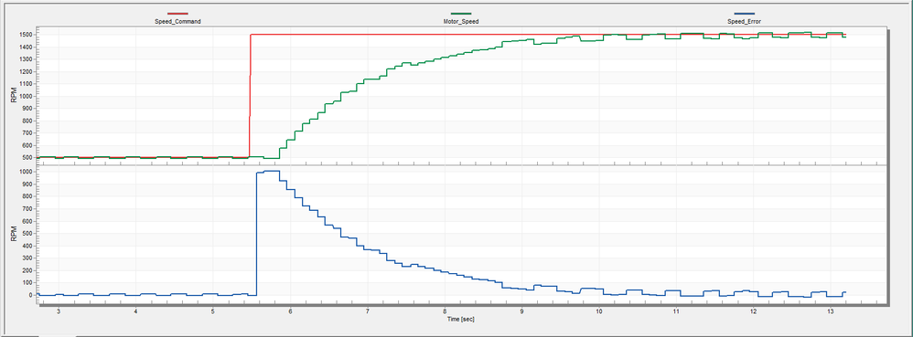

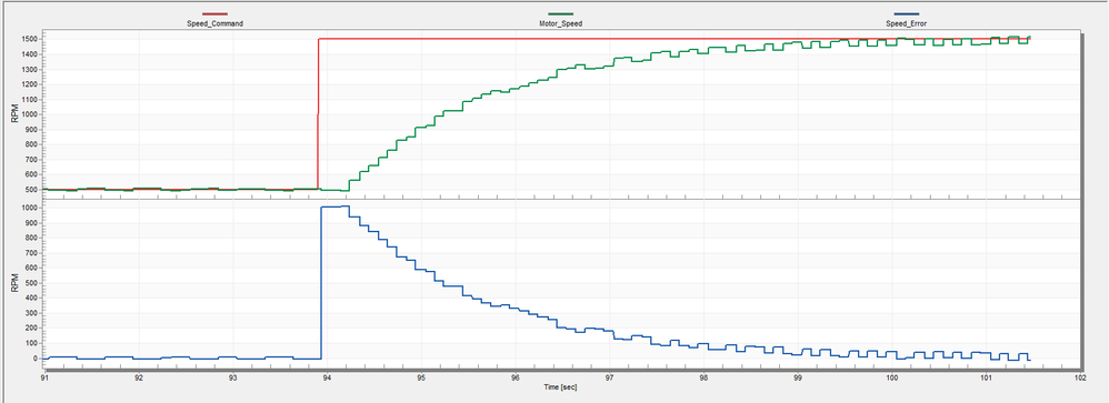

The results are extraordinary. The settling time is very small and disturbances are rejected very fast. The system successfully adapts to the variable mechanical load and comes back into the desired functioning regime.
The downside of this regulator relies in its implementation: due to the fact that it cannot be implemented using the traditional PID Controller, we need to discretize the continuous transfer function to create a digital filter that is implementable. Finally, due to numerical latency, the system cannot function >850 RPM.
Settling Time
1.9 seconds
Disturbance Rejection1.5 seconds

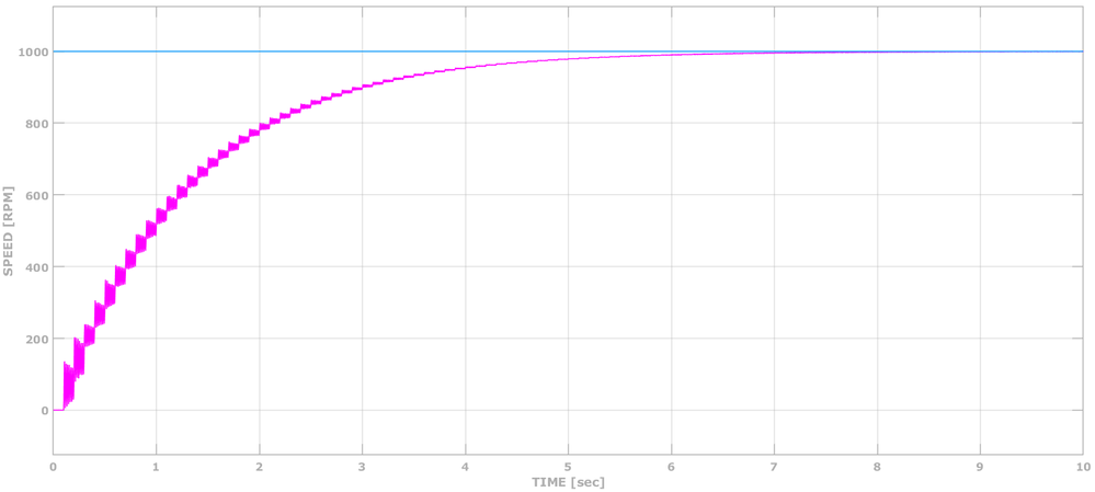

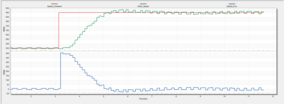

   We can further improve the performances of this PID Controller by slightly adjusting its parameters. To decrease the settling time, we can increase the Ki coefficient. The Closed Loop System's response with the freshly tuned PID Controller can be found in the following images:
   The performances shown in the above pictures meet the requirements. The settling time is good, not impressive, but not bad. It successfully rejects disturbances in relatively short time. Overall, we must take into account that the response does not include overshoot. This feature makes this controller more suitable for functioning near the limit regime.
Settling Time3.6 seconds
Disturbance Rejection2.8 seconds
