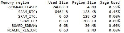

When I build the NXP GPIO Polling example from Simulink, I am surprised by the SRAM-DTC used percentage in the final report :
As you can see, half of the SRAM_DTC is used for this example app. It's huge.
On a second hand, we have developped a small similar application in C using the MCUxpresso IDE (without Simulink and genrated code features).
For information, our app is very simple and it just flashes a LED through a GPIO pin.
When we build this application from the IDE, here is the mem report :
It's better and more realistic.
Then, my question is : why mem usage is huge when I use NXP model-based example ?
thanks in advance.

The memory allocation is driven by the linker files settings. It looks like the linker files used in the toolbox are a little outdated. Please try with the files in the zip file attached  - for MIMXRT1062 (IMXRT-1060 board) and for MIMXRT1064 (IMXRT-1064 board). Copy the linker files in the next locations:
- first in [Toolbox Installation Folder]\mbdtbx_imxrt\linker_files\default\flash
- and if you already have the <model_name>Config folder or your model, replace the appropriate linker files in  <model_name>Config/linker_files/flash.

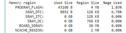

scocmr
Hi Alexandra,
Good news, the patched linker files work as expected.
In order to compare, here are the generation reports (on the left without the patch and on the right with it) :
As you can see, with your patch, the SRAM_DTC uses only 6.78% for our test application.
It seems correct now
