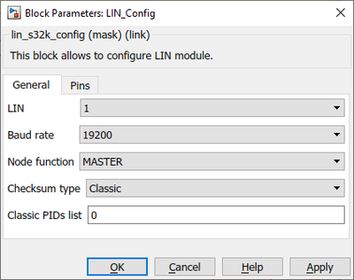

I am using a S32K144 EVB as a LIN slave. I am using Vector Canalyzer to send 5 different LIN messages. Two for sending data to the EVB, and 3 for requesting data from the EVB.
The issue I'm seeing is the checksum on the response from the EVB is always calculated in classic mode no matter what option I pick in the LIN config block. I need the checksum to be in enhanced mode. The data itself in the message from the EVB are correct.
It can be best seen in the message with ID 4. The data bytes are all 0 so the classic checksum is 255 but the enhanced checksum would take into account the PID and the checksum should be 59

I apologize for the late response. I have investigated the problem regarding the checksum value in enhanced mode for LIN communication and it looks like a problem in the SDK for the LIN driver. The function that computes the checksum should take all data bytes and add them modulo 256 together. In enhanced mode also the PID should be took in this computation. But the SDK function ignores the PID in classical and also in enhanced mode.
I have modified a source file that contains the function that computes the checksum. You can test the functionality by copying the file into "{toolbox_path}\src\S32_Platform_SDK\platform\drivers\src\lpuart". Then try to build your application as usual.
Let me know if it works.

Thank you,I had the same problem.The problem has been resolved using your method.

I think I found that another workaround to this issue is to actually select the "Classic" checksum type and leave the "Classic PIDs list" at the default "0" value.  Apparently even when "Classic" is selected, only the PIDs in the "Classic PIDs list" use the Classic checksum and all the rest use Enhanced.  Fixing the driver C code is the better solution, but this can work as a quick fix:
3,540件の閲覧回数
ruihang_wu
I tried it out and it indeed seem to work. Thank you
