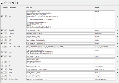

Here is my Board Initialization setup which allows CAN communication to occur:

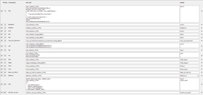

Below is where I added the Fee, Mem_43_INFLS, and MemAcc init calls and when I flash to the S32M276 board... CAN no longer works:

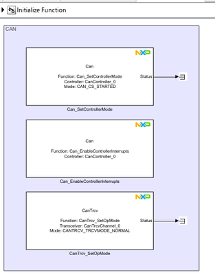

Note: I also have a Simulink Initialize Function that has the following for CAN:
