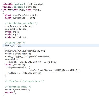

mohamed-moustafa
any code generated and deplyed to the board cause reset led flickering "sequential reset"
I exported the code to debug it found that this generated function casue to jump to reset handler
"board_init();"

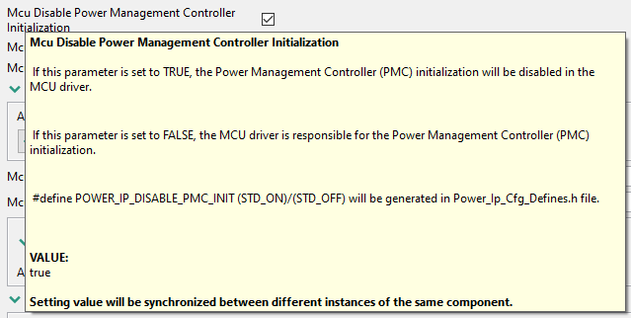

Hi, @MarcoRdzGmz,
For the problem you are experiencing, I suggest enabling the following checkbox: Mcu Disable Power Management Controller Initialization in Mcu tab - General tab (EBtresos) / McuGeneralConfiguration tab (S32 Configuration Tool):
More information about this topic can be found in the following Community thread, but in short, when MCU Disable Power Management Controller Initialization is enabled, the Last Mile Regulator is successfully turned on, and the MCU works in Full Performance Mode.
Please try this solution and let us know if the problem is resolved.

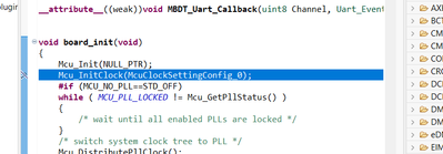

mohamed-moustafa
All supported examples cause the same problem
After debugging I think the main problem related to PMC
I cannot detect the actual line casues the reset but it is entire this function
9,269 Views
mohamed-moustafa
actually what happening is when get oy from Mcu_Init and try to step into Mcu_InitClock
it is go to reset handler
Cannot determine the main cause
