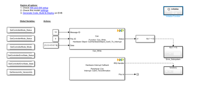

I am working with S32K3X4EVB-Q172(Part of MCSPTE1AK344), using simulink in matlab 2021b.
I have problem trying CAN trans Demo of MBDT:
I use CAN FD transmit EBT example, the board's CAN0H/CAN0L is connected to an USB-CAN device. After build and download, the RED_LED lights up, which shows there is an can error.

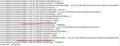

I have set the board config to S32K344-172,and other demos like Dio is working right. I wonder if the TJA1153_init is not set correctly. I am sure the EN/STB/ERRN pins are right, but I am not sure what should be write into the canExdHwId.  I have tried 6 (default value), and 4(Interrupt/CanObjectId - 4 ), 3 (Polling/CanObjectId - 3 ) accoring to this thread:how to use MBDT to initialize the TJA1153 CAN on ... - NXP Community  ,but still not work.

It shows that my configuration yesterday is right: the canExdHwId should be set to 3, whitch is the "Polling/CanObjectId - 3" in configuration file. But I don't know why should be this because I chose "CanHardwareObject_Can0_Tx_Interrupt" in CAN write model, not "CanHardwareObject_Can0_Tx_Polling". Why canExdHwId should be 3, not 4 (Interrupt/CanObjectId - 4)?

To answer the second question, the mechanism of sending CAN messages is based on interruptions, thus the hardware object chosen for the Can_Write block is the one that is enabled for interrupts.
As for the other hardware object, it is used to communicate with the TJA_1153 transceiver with the purpose of selecting the operating mode.
